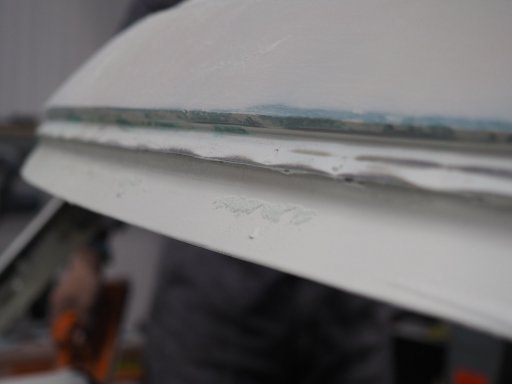

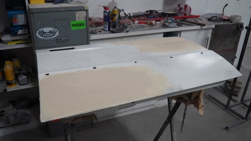

A little teaser for you all. The cab has been in the bodyshop and vapour blasted and a huge amount of work perfecting every detail to make it beautiful. It will, of course, be the originalMonza Red supplied by 68 Line Glasurit paint, but in this teaser video you get to see it right up to the Glasurit CV filler white. Dont forget to sub, follow our facebook page as we post a huge amount on there.

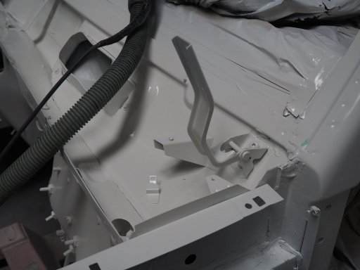

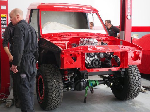

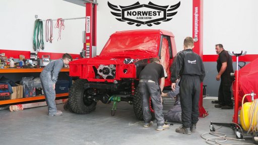

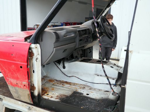

Some photos of where we are with the bodywork now.

Hi Richard,
Haven't seen the old "Red Lady" since we met up in Donegal in 2018 (I was part of the Landie Road Trip group). The build is looking amazing mate - looking forward to seeing the finished motor - will be following the build with interest.
Oh, have you managed to get Gregg's to open up in Ireland yet? or found any Stornoway black pudding.
All the best
Jim

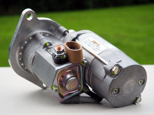

Those that have been following us closely will know that we have changed from the manual R380 gearbox to automatic. Being automatic means we cannot bump/push start the vehicle in the event of a flat battery or a broken starter. So we decided it would be a wise investment to replace both the alternator and the starter. We spoke with WOS Performance (WOSP). They use genuine OE Denso based platforms harnessing the latest and best technology in rotating electrics and retro-fit and re-engineer them to fit the 300TDi.
The starter is a 2.0Kw gear reduction platform which can be rotated 360° on its mounting plate to clear any obstruction. They also produce a fully submersible model at extra cost.
The Discovery normally has an alternator with 100Amps. This WOSP alternator is 175A, but there are options up to 400A available. Ours is using the latest generation Denso platform in a full CNC billet case to directly replace the OEM item. Not only is it far more powerful than the stock unit, it’s patented design offers up to 80% of its total output at average idle speeds which is generally when most of the electrical loads are placed on the battery.
Both units are quite simply built to be the best items available anywhere on the market, ideal for anyone who doesn’t want to be stranded far away from civilisation.
They are plug & play, fit and forget. They have over 1200 starters all based on the same principles along with hundreds of billet case alternator options.
WOSP dont sell to the public, but if you google the product codes you will find them sold in many p[laces, such as high end motorsport shops. Bearmach have started selling them too.front angled alternator.jpgin boxes.jpgstarter fron low angle full.jpgvery closeup of wosp in metal on alternator.jpgstarter rear full.jpgstarter label.jpgcloseup of label on alternator.jpg
