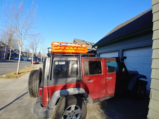

Hi everyone !
I've put together a video showing how I've build my revovery tracks mounts.
They are sturdy, cheap, secured and easy to make (Without welding)
I hope that it's gonna help or inspired someone here :wink:

I had to watch the video with sound off, so perhaps you mentioned this in the video, but you should see about epoxying those spacers to the knob so you have less parts to loose/keep track of.

I did not mention it in the video, but I was thinking about that ! I don't really know how to make this clean

Nice job. How hard was it to drill a hole in the top of the bolt for the lock? Always gave me a lot of trouble
It was actually pretty smooth !
I was worried about this so I tried on an old bolt first.
And I perfectly did it on both actual bolts ! way easier than expected ;)
