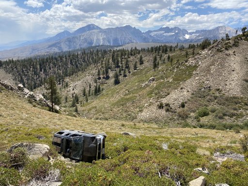

In need of recovery help:( if anyone is around coyote loop near big pine and can assist in a vehicle recovery, or know of any other option to seek out.
I rolled my 1995 4Runner down a hill, just getting into the trail, the first main obstacles. 37.176311,-118.418632. Vehicle is sitting on passenger side. I feel if I can get it back on it’s legs it will start up, although not sure if I can drive it out.
Any advice or ideas is greatly appreciated.

If you have a hi lift or farm jack and some wood or even rocks start jacking it up by the top of the passenger door pillar and use rocks or wood as cribbing to get a better position on the jack. If you jack it all the way up you may be able to push it back over by yourself or get in start it turn wheels passenger side and reverse hard and pray . I don't see a winch so thats outta question I wish you were closer I'd come get you

Thanks. Have blocks of wood, but only a bottle jack. Tried that, jacking up from the passenger side, then building up blocks. Unfortunately i guess 3ft min to get it to flip. Jack became too unstable.

If you have ropes or chains and a come-a-long or highlift, you could possibly use that rock that is below you? I can't tell how far away it is. I see you said you tried a bottle jack so I'm guessing that means no highlift. At least you are ok though! Hopefully you won't be long before its upright again and you are on your way!!

After seeing your situation I can see how a cheap portable winch and pulleys could be as important as bumper winches. I wish you luck with getting your rig upright again. The hill looks steep so be sure and anchor your truck to that big boulder before flipping it upright.

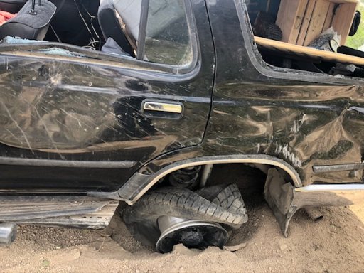

after the flip, vehicle comes to a rest on passenger side
driver, passenger, back roll up and sun glass intact, all others gone
body bent and dent
exit rear passenger window, doors unable to open

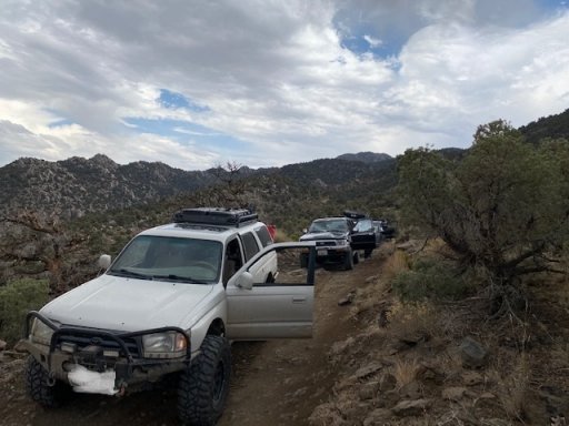

Next morning people call from all over
2 are in town by 4pm
Quick stop at the market, air down, hit the trail
Arriving after sunset we decide to wait for first light
8-19
3rd arrives at 2am, 300 miles from home
Wake up, share a pot of tea, get to work
Position 2 vehicles, one taking my obstacle in reverse getting into position (front and rear locked crawl box on 35's)
cables come out
high ground - over the top gripping the driver A pillar - first flip, stabilizer
lower - uphill tow
10 hands heave, 4 wheels back down
Hood opens, maintainance check:
battery and fuel evap canister dented, battery blood drips on belts and generator
power steering leaking from lid
no oil in plugs, no fuel leaking
after a few stuttering attemps, starting fuse is found blown- replaced - ignition successful
winching begins
rocks, ledges, and a the rear driver tire off the wheel dont make things easy (yep, popped back on and rolled.. #toyo)
high point cable prevents further rolling as we climb.. slowly
we now get a visitor, dirtbike just came by to see whats up, hang out
final few pulls and its back on the trail
high lift at 20deg to counter trail camber helps put on the spare
3 toyotas drive back to camp, gather everything and clean up

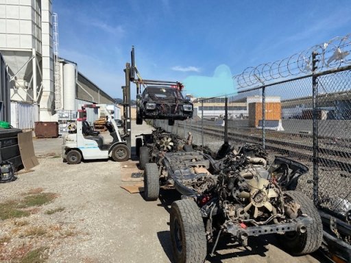

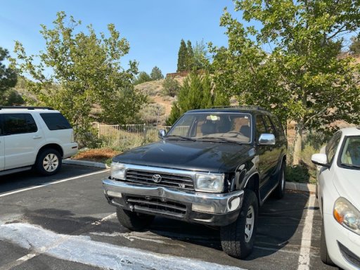

keep or sell? - keep
craigslist for 3 weeks
donor body found in reno - 700, plus 500 tow gets it to oakland
500 to transport the OG home
using a forklift bodies get swapped along with a few upgrades, 3 days work
scraps sold/ donated
now its back to the smog ref to start the process yet again(3.4 swap'd)... hoping i can pay it forward
