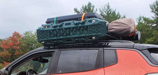

Ive had my traction boards mounted to my roof bars with big zip ties for several years now. Its worked fine that way but now im looking for a better and more user friendly way. I thought about drilling holes in one of the bars and using bolts with wing nuts through the holes in the boards but couldnt figure out what to do on the other end.
Anyone have any recommendations?

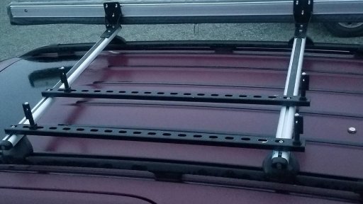

Mounted them on my WJ roof rack with two sections of low profile Uni strut the length of the boards running from front to back and attaching to the rack cross bars. Then installed the mounting pins from Maxx trax to the uni strut to match the holes in the boards. if you have other brand of board you can use all thread and wing nuts in place of the pins.

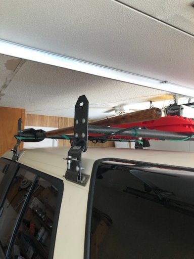

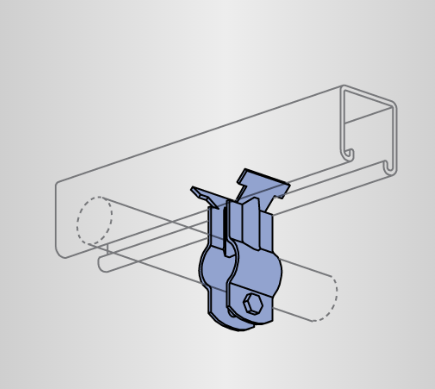

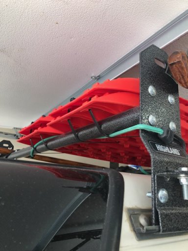

@Offroadnutz, here are some pics of my traction board mounts. The uni-strut is low profile from Home Depot painted black, I mounted it to the cross bars with T-nuts as the bars had T track that made it easy. for round bars, Uni-strut makes all different kinds of clamps, should be able to find a conduit clamp that is close to the same size as your bars, then you can slide them back and forth to fit bar spacing. for the board mounting pins, I use some from Max Trax as I use their boards and they allow me to secure either two or four boards, we typically have two on the WJ and two on the JK, but will move a set over if we are going on a difficult trail or in snow or sand. plus they are lockable. could also use carriage bolts up through the slots secured with slots, and then use wing nuts and washers to secure the boards. as a bonus drill a small hole through the end of the bolt for a mini padlock to prevent the wing nut from being removed.
