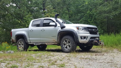

Your gonna get alot of different answers on this everyone has their favorite but that dont mean they will work for you. I run milestar patagonia m/t 33" on my truck, i went through quite a few brands of a/t tires before i found they wouldnt work for me. Milestar dont have 37" unless you have 20" or larger wheels though.
They work great in everything offroad and have really good manners on the street for m/t's and they are priced just right.

I'm running the milestar 37x12.5x20 hahah I was just going to reccomend them. Here are some reviews that sold me.

Im glad im not the only one with em anymore. Was feeling like an outsider. I asked my wife the other day who is usually driving the colorado to work around 50mi each way, do you want to switch to one of the namebrands when these wear out she quickly said nope.
