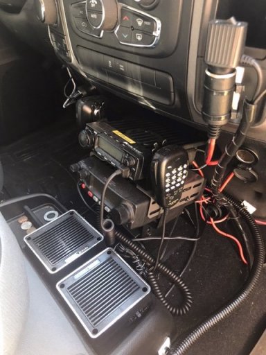

OK here is my two cents worth. In my truck I have a Yaesu FT2800 2 meter radio, and a Midland MXT 400 GMRS radio. Those two stay there. If I have to get out and still talk to people I have a Yaesu FT 60 handheld that I can listen to. I'd never talk on a radio that isn't authorized to transmit on GMRS frequencies. :-)

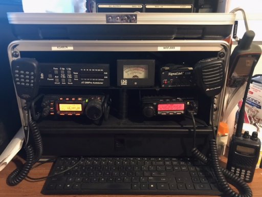

When I get out to say a campsite that I'm going to stay in for a little bit I have a Yaesu FT 857 for HF, 2 Meter, 70 cm. Also with another Midland MTX 400 radio. All this is in a Gator case. The drawer holds two lengths 25 ft of coax and wire antenna for HF, and a slim jim antenna for 2 meters and one for GMRS. I can do Voice and Data on any band we are authorized to be on with those modes. It all packs up in a relatively small amount of space.Gator.jpegTruck.jpeg
