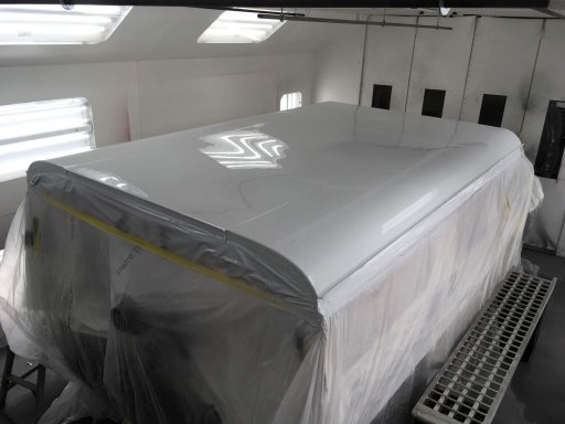

Repaint the top: Sitting outside took it's tool on the top of the truck. We had painted the hood already - it had a new but unpainted hood when I went to pick it up but my dad couldn't remember why. But the top had some noticeable rust developing on top and it needed to be addressed. The whole truck will need a paint job before long but I'm going to wait for now. I'd want to get this usable and reliable to use it. As long as the body and paint are in good condition and serviceable I'll leave the "years" on it for now.

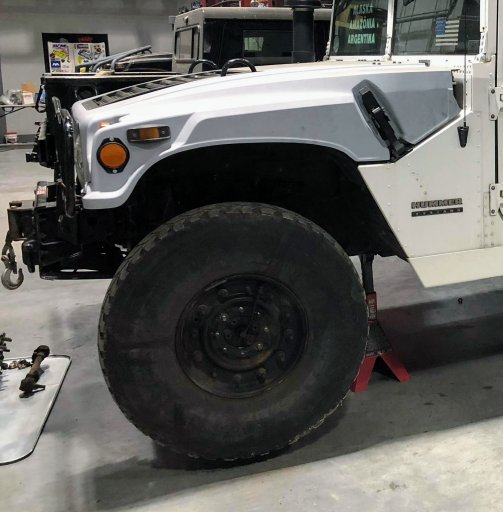

Wheels and Tires: There is a limited number of wheel options available for the Hummer H1. Additionally, many wheels that are put on H1s (that look like super car wheels rolling around town) aren't actually strong enough for the weight of a loaded vehicle (especially off road). The original wheels my dad had on the truck were 16.5 inch, two piece steel wheels with the military tire they shipped with. Better options where available in later years. The best option are 17 inch 20 bolt 2-piece forged Hutchinson aluminum wheels. They are street legal bead-lock wheels. So we've gotten four of those, power coated them and increased the tire size from the stand 37 inch tires to 40 inch tires. My goal isn't to make this truck into a rock crawler but the larger tires do allow for some better performance off road. Since the the truck is fairly limited (speed wise) on road I'm comfortable with the increased tires. I resisted going up to 42s as I don' t think it needs them. Since these wheels are $1000 a piece, got another hummer wheel that's a little less expensive for the spare. I had wanted to get BFG Ko2s (and I still might later) or KM3 but they don't have the right size in KM3s and the KO2s only go up to 39 inched... which might be enough. On the recommendation of the Mod Mafia team (they run 42's on their personal trucks) I'm starting out with Goodyear Wrangler MT/Rs. They have Kevlar reinforced sidewalls/shoulders and seem well rated at least for warm conditions. They are now a 10 year old design/technology... we'll see how they do.
Spare wheel cannibalized from another truck before powder coating. We're not using that tire though.
When on the trail I can decided to protect the wheels with steel "hubcaps" they make. I wouldn't use them on road or for anything longer that a short "trail run".
