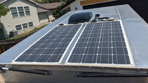

Solar - So I had originally ordered the 200 watt solid panel solar kit with MPPT controller from Renogy for this project. After much deliberation I decided to go with the flexible panels instead. Weight savings trumped the efficiency and longevity the solid panels would provide. The panels are mounted with VHB tape along with a bead of silicone along the front edge for further protection. The MPPT charger if keeping a 100AH lithium battery from HQST alive.
