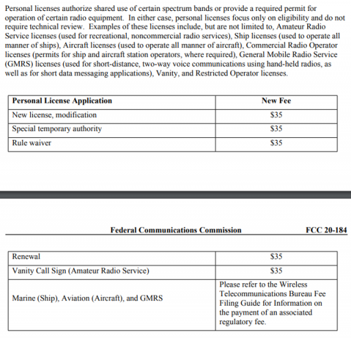

If this reduces GMRS fees as well this just made it a lot more interesting for many in my group.

I didn't specifically look for that, will have to check it out tomorrow.
I read the leagaleze as best I could, but I thought I read it was referring me to some other document RE:GMRS.
I have been trying to find out what that means as well... I have tried to search through the document but can’t find anything else at the moment... by the looks of it GMRS, Ship, and Aviation communications licenses are staying the same...

I am no attorney but it appears that GMRS (as well as Maritime and Aviation) are also included in the $35 fee schedule.
The Wireless Telecommunication Bureau Fee Filing Guide that is referenced for GMRS/Maritime/aviation is only a reference for the forms needed to file for a license, renewal, modification, etc.
GMRS is noted multiple times as being included under the "Personal License" grouping as is amateur radio. The $35 fee schedule if for all personal licenses not just amateur radio.
That’s the way I take it as well.
