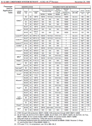

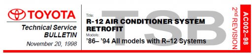

There's a Service Bulletin from Toyota, Nov. 20, 1998 for that. Here's some details.
Is your car one of these?
Dan
Its possible that it has one of these compressors but it will not be one of these models due to being an Australian import 1988 HJ70 diesel but I will check this could be good reference thanks!
