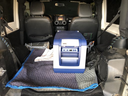

Got tired of lugging ice around, and finding my meat soggy due to ice/water penetration... Not cheap, but should help going forward.
Went for the 37qt model, and I get a free 'limited edition' cover after sending in proof of purchase. Just put it in to see size; it will eventually go all the way next to the side (where I have my recovery gear right now - that will go on top of the roof rack, behind the RTT) behind the speaker.
How critical is it to get a deep cycle battery now? What's the best size (Ah, etc.) and way to install - in the engine bay, or behind the passenger seat (or thereabouts?)
