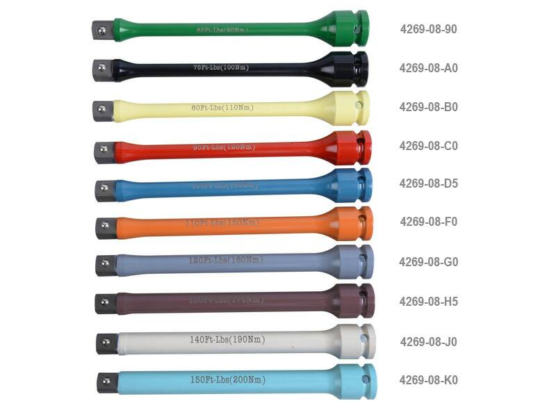

On some Vehicles over-tightening is the problem they hit the stops and then you still hear the gun going off like a 50 cal for about another 10 seconds that breaks the studs on a lot of late early model Japanese vehicles
Sent from my SM-G930V using Tapatalk
They're most likely using a torque limiting bar or at least I hope they are.
-mac
