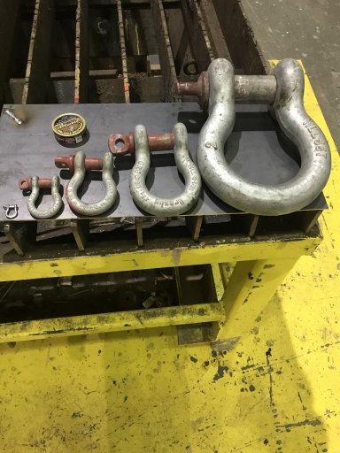

Let us begin with shackles. The most common style of shackle you see on the trails is the bow shackle. They are an essential piece of hardware for you to have in your recovery kit.
They come in a variety of sizes to suit various application. Here is an example of that. Starting with a 1/8" 500lbs WLL on the left and finishing with a 2" 35ton WLL on the right.IMG_3726.JPG
The right shackle for the job, WLL (working load limit) and getting what you pay for. For the most part we in the overlanding community tend to have some really heavy rigs. I have seen individuals on the trails that have either damaged there equipment or have gotten injured from using a shackle that wasn't rated for the load it was carrying or it had no working load limit at all. There are some shackles available on the market that are genuinely just to be used to look at. Those would be any shackle that does not have a WLL stamped into them! What am I saying?
If there is not a load limit on the shackle it should never be used in any capacity other than a paper weight. Basically don't use a cheap knockoff shackle your life could depend on it. Know what your shackles are rated for and use the correct size for the task at hand.

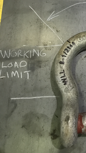

Where is the WLL?

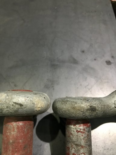

Easy way to check for deformation is to look at the pin when it is fully threaded into the bow. It should be seated against the bow at the head and the threaded end should be flush or just protruding past the bow. If it is not flush on either end it is bent and unserviceable. Destroy and dispose of properly.
Shackle on the left is in good shape shackle on the right is deformed and unserviceable.IMG_3721.JPG

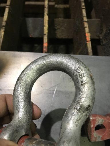

Example of excessive wear and damaged WLL markings. Unserviceable.IMG_3728.JPG IMG_3729.JPG

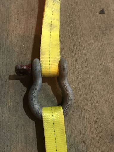

Nesting straps in a shackle correctly is also important in preventing damage and failure.
Over filling or using to small of a shackle can cause the shackle to cut the strap or cause the straps to friction bond to each other. Having the shackle in the wrong orientation can cause deformation and failure of the shackle.
Bow is side loaded, this will damage shackle. Solution is to turn the shackle 90* so that the strap rides on the pin and the arc of the bow.IMG_3715.JPG
Pin throat is to narrow for strap. This will cut the strap and possibly cause accident/injury. Solution is to use a larger shackle that fits the strap.

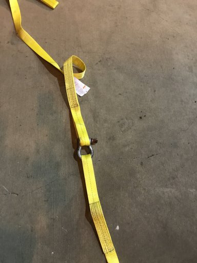

Correctly joining two straps with right size shackle for the strap.IMG_3725.JPG

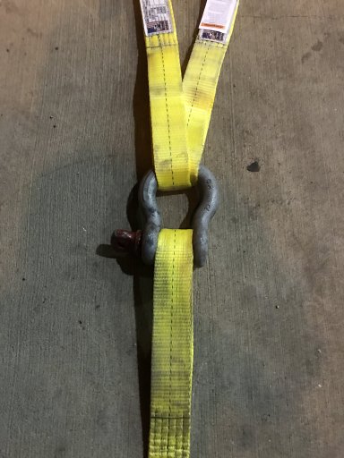

Correct nesting for basketed strap to single strap. Commonly used when using a tree saver connected to a recovery strap. Strap in pin throat could also be substituted for your winch link or hook.
