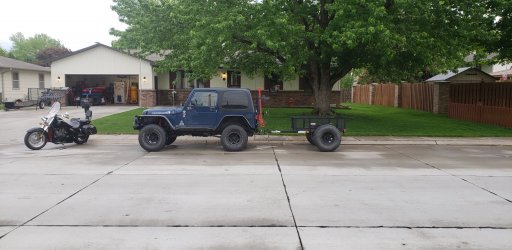

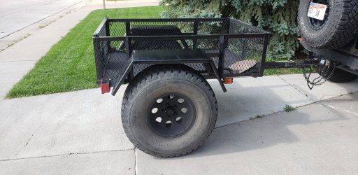

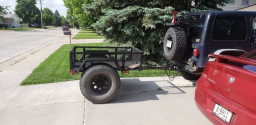

14473
I needed more room in my tj, and tried a roof rack. I really wasn't that happy...even moreso now that it is setting in my driveway. So I decided it was time to build a overland trailer. I looked at the little harbor freight trailer and decided most of it would have to be replaced. I looked at building one, but it was less expensive to buy the trailer at lowes. All metal with a floor, sides, 2000# axle, 5 on 4.5 bolt pattern (matches the tj).
I'm building this in phases, 1st buy the trailer and use it as it sets. Done!
2nd phase spring-over lift, cut and widen the axle, and put 33" tires and similar rims as what's on the jeep. Doing that so I dont need a spare tire for the trailer, and if I have a really bad day I have extra spare tires for the jeep. The extra clearance will help when pulling it off road. Almost done. Had to remove the fenders, and need to make new ones.
Up coming steps: extend the tongue; kayak mounts; dry storage for inside; articulating hitch/ able to be switched to a normal hitch; tool, battery, solar, hammock hanger??? Any ideas?

Nice job so far. I have the same trailer, I flipped the axle and lined the inside with treated plywood and mounted my RTT on unistrut.
I don’t care about matching wheels/tires, so I went with 15” white spoke trailer tires from fleet farm.
I used 1/2” spacers to widen the track enough to clear, I may widen the axel, but it works for now.
Phase 2 for me will be to lengthen the tongue and fab a mount for a dirt bike.View attachment 99907View attachment 99908

I used galvanized fenders from Northern Tool and modified them a bit to fit and welded them on

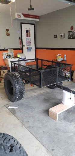

A few more pictures of the build. Fenders are on, bed mat put in. Next to look at kayak and paddle board mounts...not to forget the axe and shovel mounts too
So that's how one bends metal without a metal brake! Genius!!! I need to bend some metal for a spare tire mount myself...
Trailer looks great so far!
