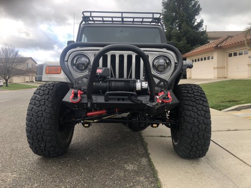

I am personal friends with the owners of Metalcloak. Matson is the marketing director and a super great guy. He calls up and says “hey man, just put in a order for your TJ. Front and rear bumpers and a tire swing out” [emoji15] You’re kidding right???? So awesome and project “shoestring” stays on course!!! Then my long time friend, the owner of Cloakworks says “ you can’t put that ugly wore out smittybilt winch on the new bumper. Says I got you a killer price in a new Warn winch with synthetic rope. I am speechless. I love my friends, and not because they hooked me up. It’s just what we do for each other.

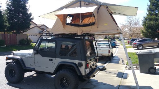

Test fitting the RTT

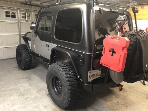

New Metalcloak bumper, warn winch and headlights
Metalcloak rear bumper swingout and accessory mount. Trashoroo, Rotopax and highlift jack

How is it driving with the RTT on the rack? I’m considering getting a rack and putting the tent on top but I’m also concerned about the center of gravity being way off. My TJ has a 4 in suspension lift with a 1 in body lift.
I really don’t notice much stability difference. But I also haven’t gotten into any real bad off camber situations either. I have a 4” lift also
It definitely doesn’t help the fuel mileage
If I were you, I would highly consider removing the body lift if you can. My experience with body lifts, they can create more issues than not. Just my .02

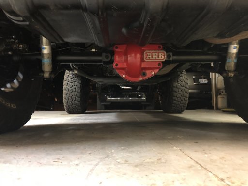

So I’ve finally got to drive the Jeep around a little bit since I put the 44’s in. The alignment was WAY off. Had it aligned today and asked them to put in as much caster as possible. Steers and handled much better now.
But I put 4.88 gears in with the Dana 44’s and man, I think I chose too high of a gear ratio for 35” tires. 22-2300 rpm at cruising 60’ish mph.
Will be better for crawling l, but not a happy freeway rpm.......and really don’t want 37” tires

Here are some pics of the stuff I’ve installed and not installed showing a real comparison of before and after IMG_1267.JPGIMG_1252.JPG
