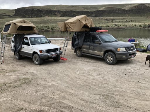

My daughter loves her 93 Montero... first car, and she’s already done tons of overlanding with it. The local Mitsu dealer has had all the parts we’ve needed so far, at very reasonable costs. Just finished valve guide seals and valve cover gaskets on it... Dakar winner multiple times ya know...
Reactions: Renbuguy
Thanks for the pics James! I do like the Montero/Pajero. I would like to get a diesel one though. I've also read that lifting them is limited to about 2 inches, but that might just be enough for some added ground clearance. Do you know if your daughter's has a locking rear diff? Locking center and rear diffs seems like a great bonus to any 4x4.
Any idea what fuel mileage she gets? Mid 20's or...?
MPG: ~15 according to the window sticker
Locking rear diff: Not on this model. It does have limited slip in the rear though.
Locking center diff: Yep.
I haven't really looked into lift kits for hers. In stock form it is fine for what we do. I did crank up the torsion bars in the front to level it out... I don't like lifting vehicles more than 2" to 2.5" anyway, because then you have to deal with fixing drivetrain angles... I don't want more problems, so I try to keep things as stock as possible (regarding the running gear).
