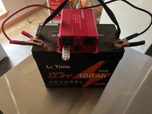

step-daughter and her husband were staying out in our garage /apartment when a hurricane hit and knocked out power for a week. they wanted a fan and a light, so I just went out to my shop and got a lithium 100ah battery and one of the cheap inverters I had and just clamped the leads to the battery and they had a fan and lights. I did it as a quick fix, but realized that the cheap inverter supplied everything they my big unit supplied, only at a fraction of the cost and ZERO time to built and wire up.
so...from now on, when I need emergency power, I just grab a lithium battery and get one of the inverters and in less than 5 seconds (time it takes to clamp the leads to the battery) I have 110vac inverted power, USB ports for phones LED lights and one of my inverters even has a 12vdc port for my Dometic fridge. the battery has handles so its easy to carry and the inverter can be Velcro straped to the top of the battery or duct taped, tywrapped, etc.
