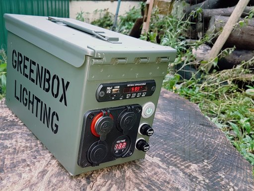

image.jpg image.jpg image.jpg ive been thinking of putting a dual battery system in my truck linked to my trailer , dont know why but allways worry about running my batterys down at a overlanding show seen these and orderd one any one else carry one

Dont forget to take some pics as you build it wish i had the skills to do it but greenbox
Seem to be competitive on price and really help full Does some handy lights allso
I have the same problem, no electrical skills. They seem to be about half the price of a Goal Zero, I guess you could build your own for half the cost of a Greenbox, but then I'd run the risk of setting fire to something.
. Ha ha yep thats my fear
