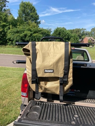

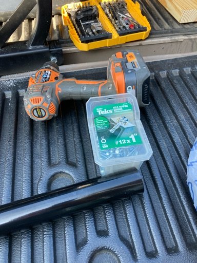

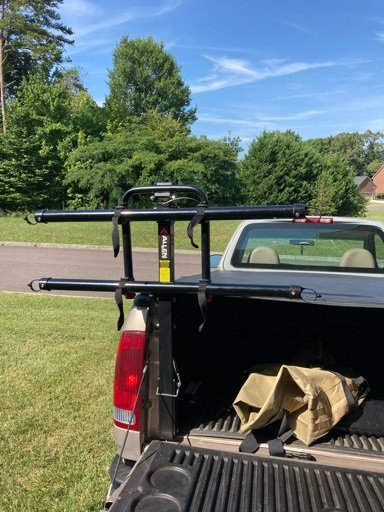

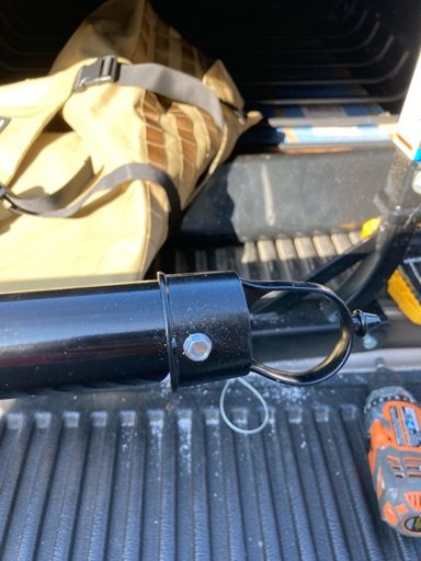

My next hurdle came when I needed to carry the trasharoo as I didn’t have the funds for a bumper with a tire mount and swingput and I don’t want to spend the money for a hitch mounted tire carrier for the 4runner. So the lightbulb went off and I found a used bike carrier on Facebook Marketplace for $50.00. Went to Lowe’s and purchased a black 1.5 inch fence post for use with chain link fence. I cut the post in half at 36 inches and mounted fence caps on the end with self tapping screws. I then mounted the poles on the bike carrier and the trasharoo to the the poles. I was able to wrap the straps around the poles and tighten them up.
I have not had it put yet but will let you know how it works. I am also going to mount traction boards to the back of the bike rack which should cut the wind resistance down on the trasharoo.
