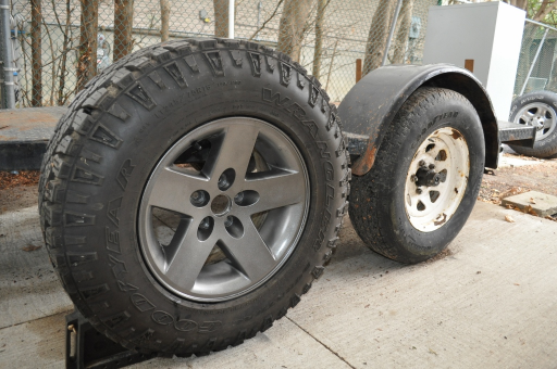

- wheels 16" Jeep Moab
- tires 245 75R 16 Goodyear Duratrac

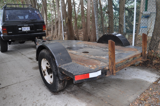

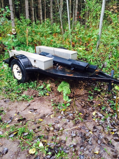

Here's what I started with. This pic from the ad for it was either taken on the day it was painted or it was more likely raining. It looked shinier that it was.
The trailer was well constructed. I understand it was used by a welding company to trailer a mobile welder to job sites. The round fenders were well built and nicely tied to the frame with deck plate running boards. It had 14" wheels and tires that were in pretty good shape. I wanted square fenders though and 16" wheels and tires to match my Jeep TJ & XJ so I decided to tear everything off.

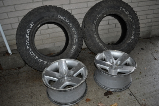

I sanded down a pair of 16" Jeep Moab wheels and painted them with Duplicolor wheel paint. I'll eventually get them powder coated. I went with graphite to distinguish them from the silver wheels on the tow vehicles. I found an almost new set of 245/75R/16 Goodyear Duratracs on Kijiji to match what I have on my TJ. I also needed a set of spacers to mount the wheels to the hubs. I may replace the axle so I can add brakes. Unlike a lot of axles the current one does not have the flanges to bolt the brake backing plates to. If I can fabricate something suitable I'll go that route. If not I'll build a new axle.
