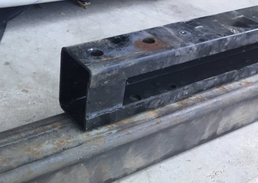

On to the reasons this thread is here and not in trips. I mentioned a teardrop is never done. I've not been totally at ease with the tongue on Rose since I built here. The stock tongue on the frame I used was a piece of C channel, which was okay, built also twisted some when I used the tongue jack. Consequently I always used some other stabilizers when parked and unhitched from the tow vehicle. In the last year I've also been towing with thecopcar, which has a longer wheelbase than any other I've used in 11 years. So, out with the old and in with the new. I was able to buy some steel by the foot in lieu of buying an entire 24foot stick. Rose is getting an upgrade to a 2-1/2" square by 1/4" tongue which is also longer than original. Easier backing, plus more space to mount the tongue jack, and maybe even a spare tire mount.

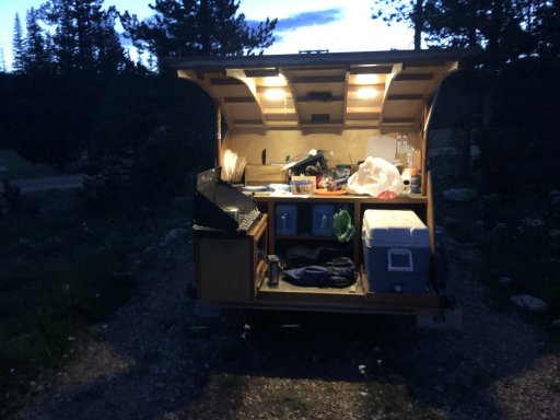

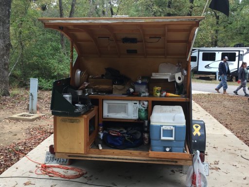

Some galley views for on and off grid camping.
First up, in the Snowy Range on the continental divide in Wyoming. Definitely off grid. Note the water jugs on the shelf between the cooler and pantry. A bit messy after 11 days. Oops

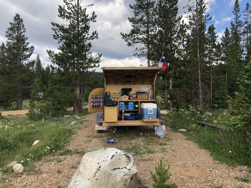

A bit better shot the next morning.
Definitely on grid here. Note the water jugs are gone. Rose has some creature comforts to ease reheating coffee, making popcorn, and other stuff.
