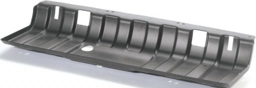

I have the AEV front bumper on my Jeep JK Unlimited. The AEV front bumper, has an optional skid plate, that ways 23lbs
I'm not sure if the skid plate provided that much protection. It was also removed today. Time will tell if this was a good idea or not.

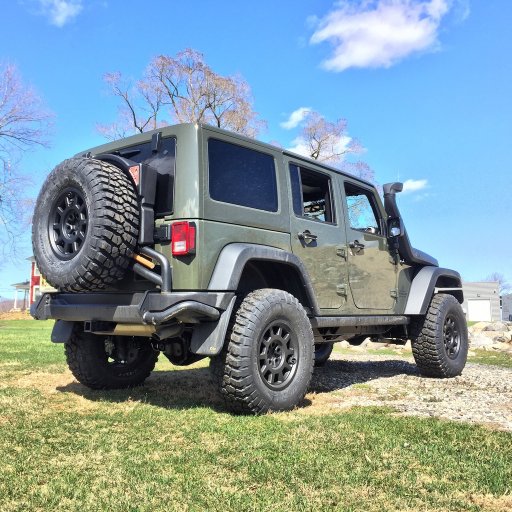

I have chosen to mount my 285/70R17 AT on much lighter wheels. I chose AEV Salta wheels.
Per AEV they way 22lbs each. That is a 21lbs weight savings, compared to my current per wheel weight of 43lbs.
I'm also going with a smaller tire:
My current tire is Goodyear Duratrac 315/70R17 at 60lbs
I'm changing to Goodyear Duratrac 285/70R17 at 54lbs
This will net me a total of 135lbs reduction in my rig. With smaller tires, my fuel economy and range should improve.
The wheels just arrived today, so they will get mounted to the tires this weekend.
I will keep the other wheels and tires in storage, for when I need them. I will post the before and after photos when the swop is complete.
