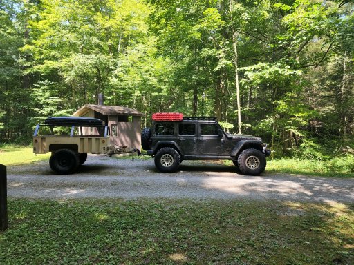

You may want to look at surplus military trailers. Price will generally be lower and you can build to meet your needs if you want to take the diy approach. The picture is of my project, had a custom rack fabricated and built storage in the bed of the trailer.

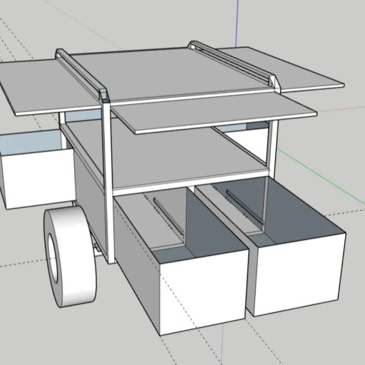

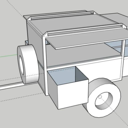

I have been designing my own to fit my needs. I will be towing it behind 2 different vehicles and a variety of terrain so I designed it around that in mind as well as how I pack and mainly the tire size I figured it would need to get through to some of the spots I planned on taking it.IMG_20230119_210745_689.jpgIMG_20230119_210745_844.jpg
The top will hold larger gear like tents, axes, shovels, traction boards ( I may still split it into 2 sections but the idea was to be able to access everything in the top no matter how it was parked). The bottom will be a series of drawers for cooking gear, tools, coolers, fuels, etc. The roof will have roof rails so if I do decide to go back to a RTT I can fit it up there, but will likely just haul kayaks.
The only reason for the trailer in my case is because my vehicles are small on the inside and I have a growing family. This will allow me to have less gear crammed in the vehicle and help get things a little more organized.

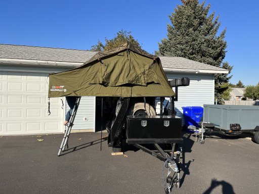

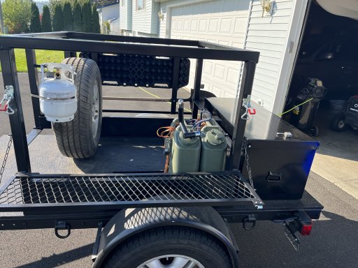

KISS. KEEP IT SIMPLE ST$#@()
took a harbor freight, added 3500 lb axles and 2.5 inch hitch and reinforcing steel. Used take off Toyota rims to match my rig. Added boxes front and back and made a frame to hold my RTT. The center is lockable and I carry 2 pro pain tanks, spare, pottie, 5 gallons gas, 15 gal water, and blackstone griddle, chainsaw, propane fire pit in the center, front box is kitchen, rear box is other supplies. I have owned 7 rvs. Jeeped off-road my hole life and built a lot of storage things for my rigs. This was built on the design of simple. If I am out of town on a long trip and a bearing fails, they are the most common bearing and I can get them at any auto parts store. its 1500 pounds and can be towed by most anything. Wheel lug pattern is very common and you can get trailer tires to fit. Same as my rig so 2 spares. If my rig breaks down, it can be towed home with a uhaul truck. Stayed leaf springs because I can buy trailer springs in most towns and the leaf spring is strongest and most tried and true system. And no slides. Slides will not hold up to abuse in off-road or just constant gravel road situations.
