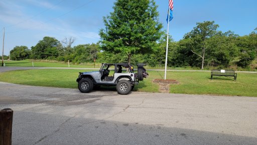

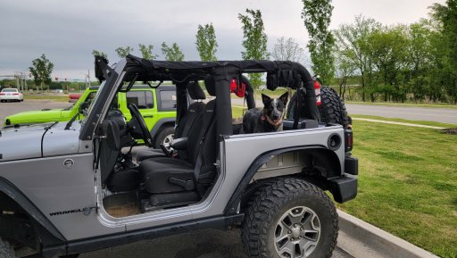

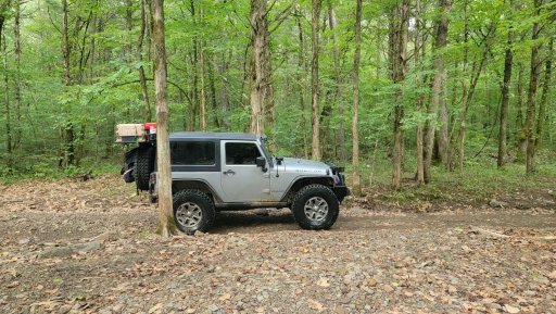

Looking for advice on upgrading the suspension on my 2 door jk. Currently I have the 2.5 AEV Dual Sport lift and have no complaints aside from the sag and occasional rubbing on the back when fully loaded (100lbs dog, 1-2 Jerry cans and basic camping gear). We're looking at adding a RTT in the near future so im anticipating even further sag then. I'm looking into possibly going with the Metalcloak 3.5 Game Changer. Here are some pictures of the current 2.5 lift..sorry I know they aren't the best. Thanks in advanced for the advice!

What tire size are you running? Stock rims have a really bad offset and will rub with bigger tires no matter what lift height. You can add a good quality wheel spacer just to try.
Metalcloak springs are not ideal for carrying heavy loads as well as the aev aren't...
Teraflex has springs in Overland spec which are stiffer and good for heavy loads, Clayton offroad springs are said to be very good at load handling as well and I use the Rubicon express springs and have no complaints.
Basically every linear rate spring will perform better under load then progressive or multi rate springs, your aev are dual rate springs, metalcloak also...
I would change to a linear spring and different wheels or wheel spacers and maybe add a spring spacer to level if required, you can also take a look at the sumosprings from supersprings.
Sumosprings and spacers are just bandaids and should be used with care.

Thank you, I'm glad you brought that up. I was thinking that the dual rate would be better for a heavier load but I understand what you are saying.
Also, I had wheel spacers but still had a little rub now im running a wheel with -12 offset with 37's.

So with 37s you might want to go to 3,5" lift, preferably a lift kit with the right bumpstop extensions and so on. Takes lots of guess-work out of it.
