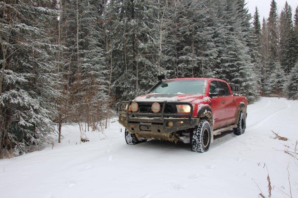

I have a 2013 Tundra and went with a 2" ome lift with heavy springs in the front and Dakar leafs in the back.
Works great for me on rough roads and such. I've driven it out to Moab a couple times. Once solo and once loaded with dirt bikes and a trailer. I'm very happy with the ride and how it sits. The lift levelled the truck and rides nice both on highway and off.
I may make some changes to upper control arms etc. But I'm pretty happy the way it is.
