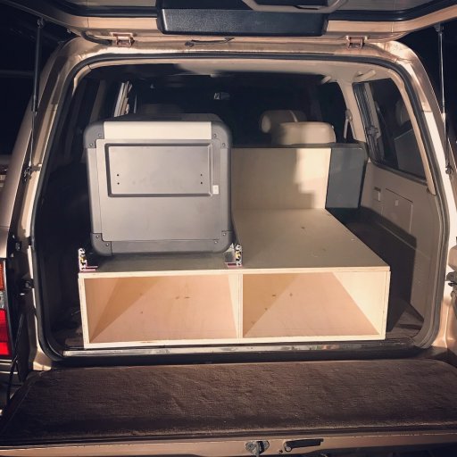

This was my solution. Frontrunner 41L tank that is only 3” wide. Sits directly behind the rear seat and is sandwiched by my drawer system. I run a pressure actuated 12V RV pump that gives us running water to the back of the rig. Works great!
