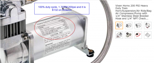

Check out Amazon, there are a lot of 12V air compressor options that should fit any budget. I found a great compressor there that does 1.7CFM, up to 200psi and it is around $100. You could add a tank and have a complete system. Or, look at Viair, they have one for about $100 with tank.
If you have big tires, you need one that has higher CFM.(volume) Any compressor can make 100psi, but it is the volume (CFM) of air that fills the tire. This will be the difference of 2 minutes per tire or 20+ minutes per tire.
Also look at duty cycle, this is how long you can run it, % on time vs. % off time. The higher the better. 100% is ideal, but not always cheap. Cheaper (Low duty cycle) needs to run short times, then left off to cool, or they burn up. 100% duty cycle means you can just keep it running non-stop.
So, a high volume, 100% duty cycle and add a tank and you will be the envy of everyone when you air back up. With the right parts this can be done for under $200-250.
