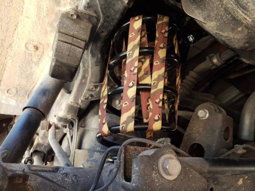

Suspension update: Slee was very helpful but couldn't schedule the job for a few weeks. This was my short term solution, till further notice View attachment 69796
