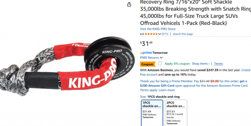

the only thing i regret the weight of is snatch blocks and tree straps. at about 20lbx4 and 4x10lb big a$$ straps...
If you're using synthetic winch line, those heavy snatch blocks are made for steel cable and not ideal for synthetic line.
These are just a few bucks more than a snatch block and weigh a lot less.
