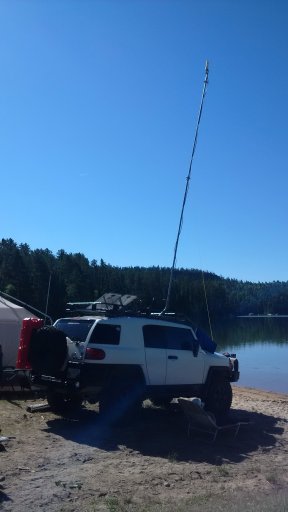

I got the following.
https://www.costco.ca/Uniden®-U2-Cellular-Booster-Kit-with-Outdoor-Omni-and-Indoor-Whip-Antenna.product.100230913.html
It worked ok just on the base on the roof rack... but it seemed to be getting some feedback loop as the outdoor antennae was too close to the indoor antennae (sucking and blowing at the same time).
We camp in a lower area and it's difficult to navigate in and out of and if I cut my leg off with my chainsaw my wife can call for a chopper, lol.
This year I got an extendable 20' mast.... lol.
Works fantastic now.

I have to reinforce the bracket at the base... pretty sure it's not made for a free-standing 20' mast... lol. It's just a basic base you see satellite dishes mounted into.

Height is the key. Somewhere in spec is minimum fifteen feet between two antennas,as you said feedback. As above you need something to boost.

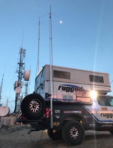

There you go! As with any transmissions, it’s all about getting your antenna out there. I use a similar set up for work. Although, we rarely put the cell antenna up as we can usually position ourselves where we can pick up a cell tower or, there’s just no way and we use satellite service.
