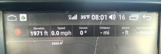

I took a look at things and did find the auto offline mode setting, turned it off and will see how things go in the morning. One thing that makes things difficult on the app is getting to the menu. For some reason the OB1 app draws full screen under the top notification bar, which has a home button on one corner and a back button on the other. It makes it difficult to get a good push on the menu (hamburger?) icon. Seems to be the only app to do it as all other apps stop short of the notification bar area, other than OnX which actually goes full screen and covers the top. I will snap a picture in the morning to give that more clarity.

So here is an example of how the OB1 app is drawing under the notification area/top bar as compared to other apps. The search and menu buttons are quite hard to press without hitting the back and home buttons. As far as the offline mode problem, all seems to be good after unselecting the auto offline mode.
