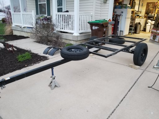

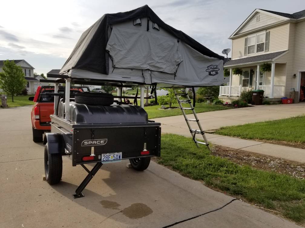

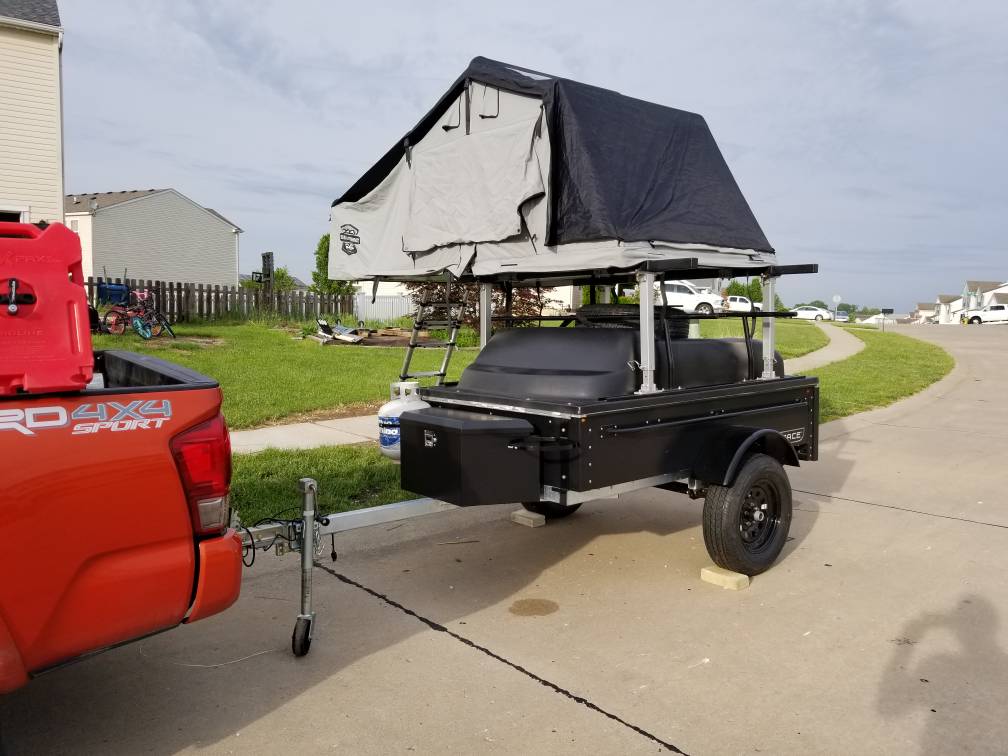

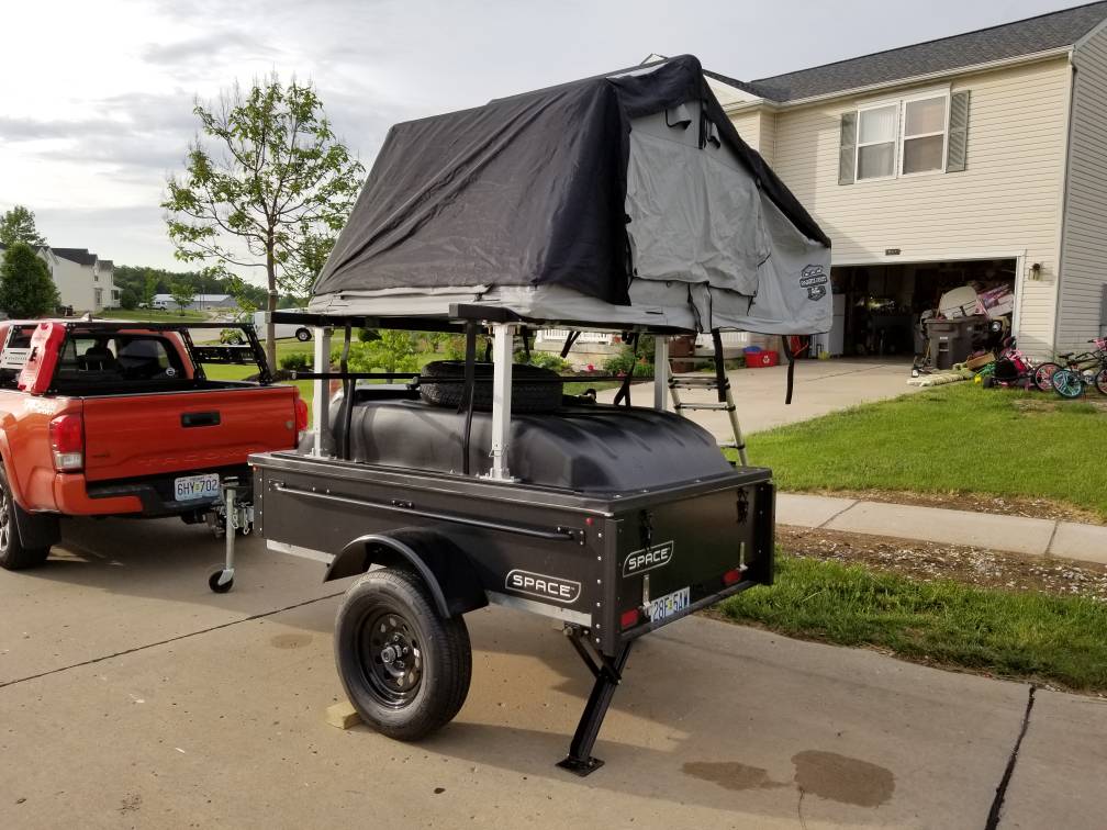

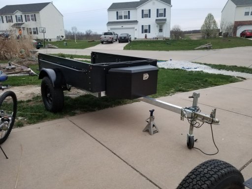

So I did a thing this weekend! I upgraded the frame of my Space Trailer I had the XL longneck model but the frame just was not beefy enough for my liking. Plus I only had the 13 inch wheels and wanted to go to 15 inch wheels for the height and clearance.

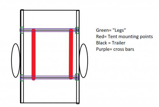

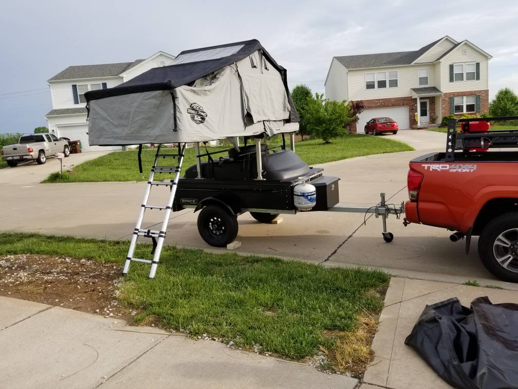

I also added a custom set of These I had them make some custom ones that are not @ the 15 degree angle so I can load the RTT on it . I've got a Mt. Shasta Extended Stargazer with annex on my tacoma thats about to find a new home.

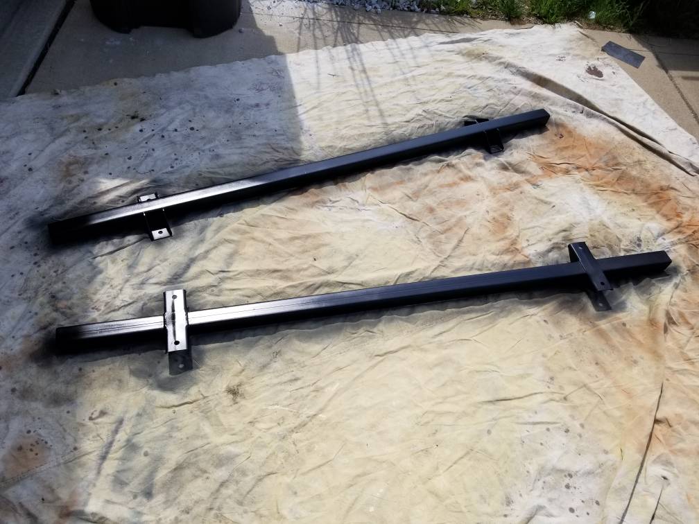

The only thing I need to do is make some crossbars. I'm trying to decide if I should go aluminum or if I should do steel. I like the idea of steel because its sturdy but they weigh a ton! That and I am a little worried about the steel being bolted up to the aluminum I read in a few places that can cause corrosion of sorts.
Thoughts?

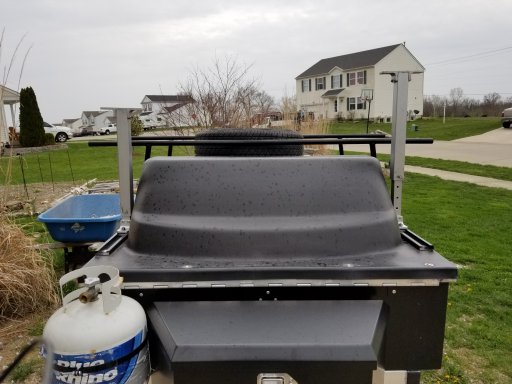

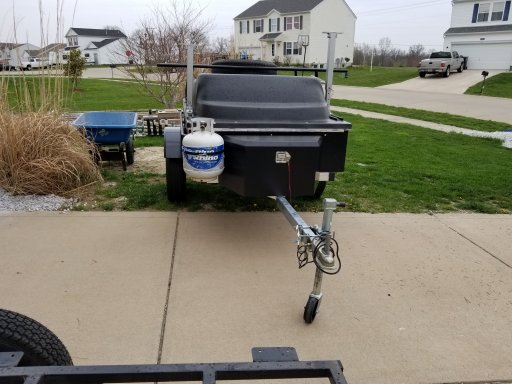

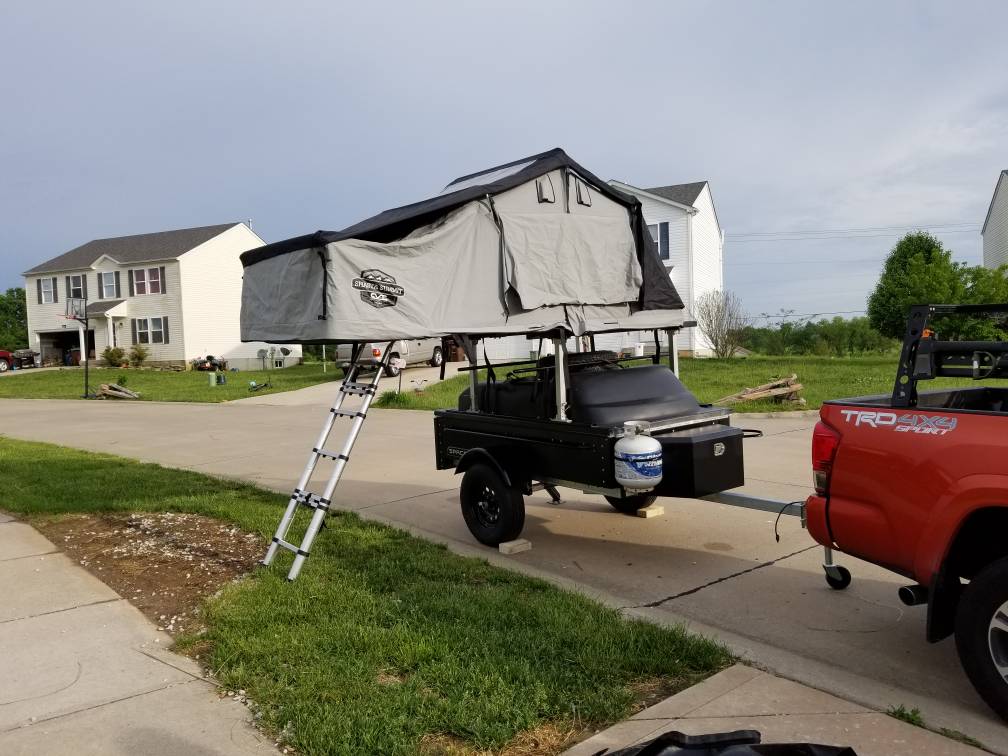

Also mounted a tongue box and one of my propane tank holders. I've go another one for the other side but it started raining on me!

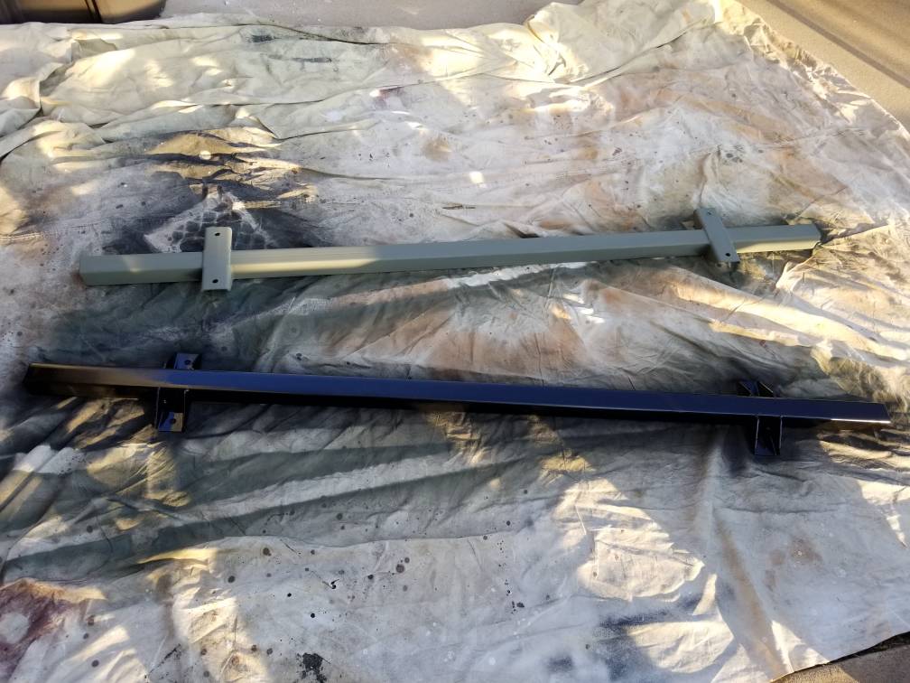

Got my crossbars made and painted.

Since the uprights are aluminium and the crossbars are steel I used rubber band between them to avoid that nasty corrosion.
