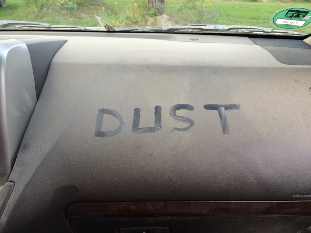

Made the mistake of running the air (not specifically the AC) last year (even though the windows were open) in the very dusty Alps. Sucked up so much dust into the system before the cabin filter. I'll probably have to get it professionally cleaned. After the trip, when I did turn it on, big puff of dust from all the vents. If it's dusty, I'd say keep system off
. My dash tells the dust story.
