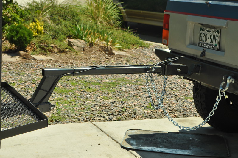

My tongue is different from most, being mounted soo high. It is also longer. It has never been a problem and allows extreme articulation. I may shorten it 6 inches some day when I have time, but it has never given me any issues either on or off road.
I like your design. It covers a few different issues with simplicity and strength.

Lots of good info there. People that don’t know almost always ask sarcastically if my 5ton pintle is big enough for our little 1/2 ton trailer. I just smile at em. My tongue is just long enough to open the swing out tire carrier. The tongue is also bolted up using grade 8 bolts. I thought about running a tongue all the way to the rear, but I do like using the trailer as a crumple zone. I may someday have a 14”x14”x48” basket fabricated and welded to the front to carry the tent and tent gear. When that happens I’ll lengthen the tongue accordingly. What are your thoughts Scott? ( crumple zone and bolted on tongue )

To be honest, I never thought about it. On my new build, I'm running light tubing but my angles are strong. If hit hard enough, I'm sure my trailer frame would "diamond" slightly and the trailer would shoot off to the side, bending the tongue. The M-100 would probably bend the tongue then shoot off somewhere.
I'm not a fan of full length tongue's. Their strong but, what are you going to pull behind the trailer? If you were putting enough weight on the tongue and needed more support, I would tie it to the front of the spring hanger. One tube straight back and two triangulating. Anything behind that In my opinion is just extra weight.
You do know, I'm going to have to study this now. I never gave any thought to someone crashing into my trailer, nor have I seen the result of it with anyone I know.
