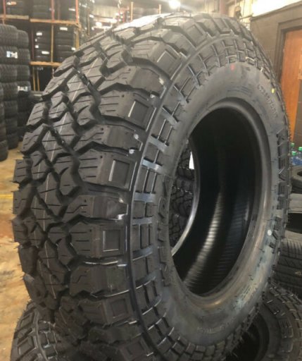

Anyone else running these? I've read some pretty terrific reviews on this tire that looks very M/T but is in fact an R/Tl and rated as an 8-ply D load. They do have a 10-ply E but tough er to find. A bit rounder profile and at 10.5 should keep most of the tire under OEM fenders on JK/JL/JT models with adequate backspacing.
315/10.5/17 measures out to essentially a 34" (280/80/17)
Balances easily
Has proven itself in rain, snow, mud, loose gravel
As quiet as most A/T's, quieter than any M/T it compared to
3-ply sidewall and D load (nice middle ground)
Price point is excellent in a $ per mile comparison ($712 for 4 OTD at Wallyworld)
Priced better than any 285/75/17 (34") A/T or M/T Ive found

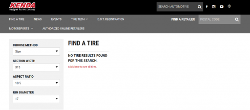

You sure of that nomenclature, because it is blending two separate and uniquely different measurement systems?

20099
They list it as 315/10.5/17. Its not technically correct, but I think they are just marketing to the 35" crowd. I just ordered some for my JKU. Read a report from a guy who has 15k on his and says its the best tire choice for his JK he has ever made. He measured his with 32psi, mounted at 34.5" non weight bearing on an 8.5" wide rim. Drops to a fraction under 34" under load on his JK.

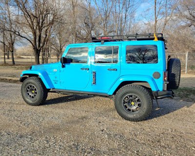

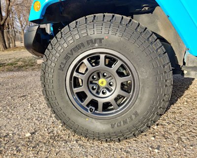

So I ordered, installed, realigned and have put about 1,000 miles on these thus far. My notes thus far
There was one tire that took quite a bit more weight than the others to balance. Not enough to cause concern, but it was an interesting fact.
Wear has been excellent. Started at 32psi on a 40°F day which grew to 37psi at temp on a 75°F day. Dropped to 30psi cold and after a longer trip this weekend settles in at 33psi. Very smooth running, reasonably quiet considering the tread pattern.
Had a couple miles long sloppy mud/water trail I ran out in Turkey, Texas. Zero issues. Fjorded standing water at hwy speed as if it weren't there. No play in the wheel, just the slight slowing of speed in the water. Narrower than a 12.5 it stays inside the fender except the rounded outer edge. Had some mud spray on the sides of the rig but over all, not so bad.
Heading to the cabin this weekend and it will get its first paces through mud, dirt, small/med/large rocks, steep craggy hill climb, snow and ice. Great looking and performing tire thus far. Happy I took the chance on it.
