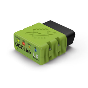

On the trail or road I use an OBDLink LX Bluetooth dongle and the Torque app on my phone. It works fine for simple things and reading and clearing codes. It also doesn't take up any room in the toolbox.
At home, I use a TOPDON Phoenix Plus ECU Coding Scan Tool. It goes a good bit deeper and allows reading codes from the ECU, BCU, ABS, TCU, and SCS. It also allows the programming of keys and fobs and can read manufacturer codes. It is also handy for testing switches and sensors individually and activating solenoids, the ABS pump, and other systems. If you don't do your own repairs it's overkill but if you work on your own vehicles it's a handy tool to have.
