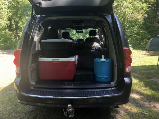

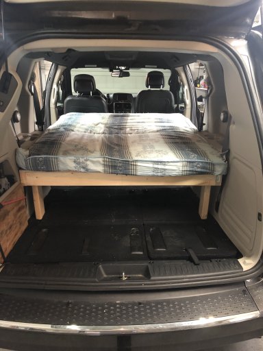

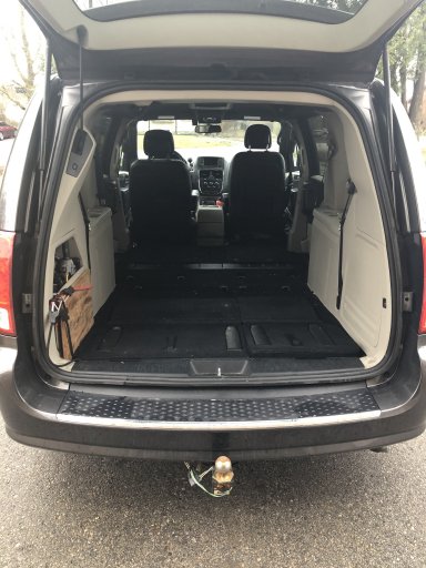

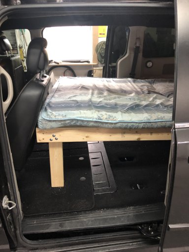

Ok, let's get it out in the open, YES its a minivan, YES its 2wd, & YES people think this is crazy, but yet here it is. For years others have built 2wd full-size vans for overlanding, some even converting to 4wd (Sportsmobile, etc.,) and building some of the most capable rigs on the planet out of them, but that's not this build. I'm not looking for a rig that can take on rivers over 3 feet deep or rocky mountain passes, I'm building out something that can take me down dirt roads, forrest access trails and logging roads and of course down the highway. This platform allows me to build out sleeping quarters inside, keep the fuel mileage respectable (I know many of you may have issues with that) and most importantly, allows me to just get out there and explore my surroundings.
Now, on to the build:
Currently running BFG K02's LT225/65/R17 on OEM Rims
Princess Auto roof basket with extension (& soon to be 22" light bar attached)
K&N OEM replacement filter (cuz we all know they add like 50hp :sunglasses[emoji4]
I have a 1" lift in my garage awaiting installation.
Will be adding a Magnaflow exhaust and custom oil/tranny pan skid plate in the next few months

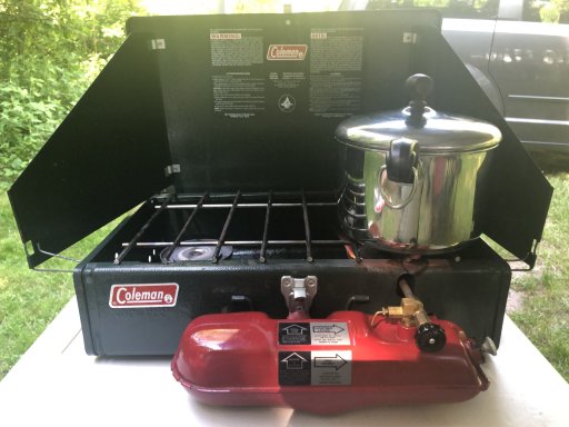

The living quarters is temporary as its also a daily driver but consists of a double air mattress on the floor for a bed, bug screen to cover the hatch for ventilation and the usual camping equipment (Coleman Stove & Lantern) fold up table & chair cooler & I also have propane hot water on demand. I will post photos of the living arrangements soon.

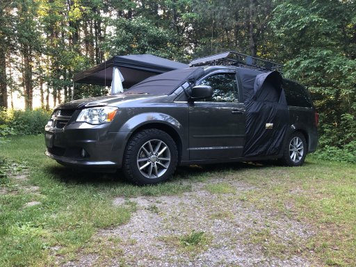

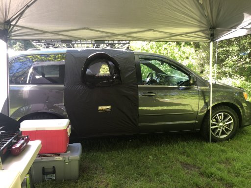

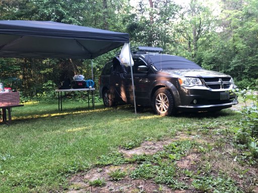

So this happened today, as I’m out giving the van a shakedown ride on some soft sand trails I run into a barrage of cops blocking the road. Apparently some dude tried to run away from them and spun out his car making a turn onto the trail. Had to sit for 15 mins as they recovered the car with a tow.
Anyway, the K02's performed just as they should in the soft sand and over rocks.
