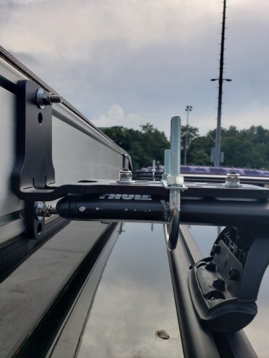

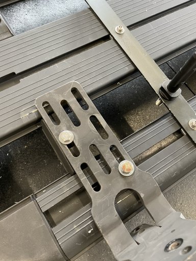

Has anyone installed a nomadic 270 awning on a pioneer platform? looking for advice on the installation. see pic below. using t-nuts and the supplied hardware only allows for connection to the outermost rail. it is solid but applying a twisting force on it, especially at full deployment, causing the inboard part of the bracket to lift slightly.
Wondering if someone has installed and what was their solution. options i have thought of so far:
1. drill through the next plank. Con - would rather not
2. ubolt around the cross member. Con - supplied u bolt wont fit around thicker cross member. also outer brackets don't align with cross member. moving the back one forward would leave more of the rear cantilevered where the weight is, not ideal. moving the forward one forward to catch the cross member would remove one bolt as it would fall on the slot for access. - could maybe locate a square profile u bolt or bolts and plates.
3. some sort of "L" bolt or plate system and bolts to "clamp" it to the plank.
what were your solutions? thanks!
Reactions: LumixLab
Well. I was impatient leaving it that way so i solved my own problem. would still like to hear other solutions. here is what i did for anyone else looking for a solution:
1. found a zinc repair strap at the hardware store that was relatively thick and rigid. bonus - already had holes and they were exactly 1.75" same as the bracket. slightly offset but no drilling required.
2. Cut to fit with an angle grinder.
3. used 1/4 20 hardware all stainless steel with lock washers and nylock nuts.
4. re aligned each bracket so it was centered over each cross bar. this resulted in more cantilever to the rear, and only one main bolt at the front. - trade off....
5. used hardware to strap down. where the supports are it couldn't be as far inboard as i would have liked like the center bracket.
6 SOLID NOW!!!

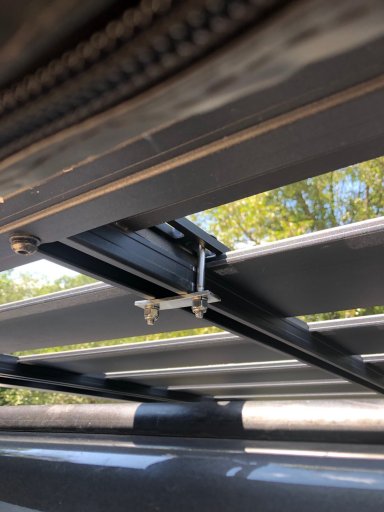

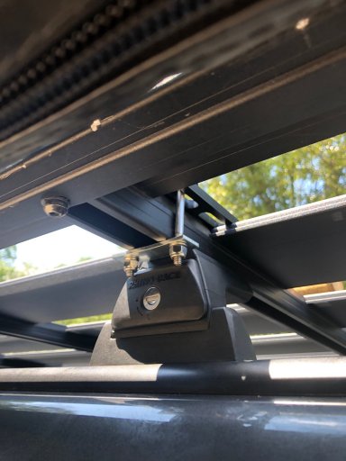

I use Pacific trailer, as hardware stores sell crapy plates with u-bolt. I will make picture for you as my truck went for the tire service , but U-bolt alone you get an idea it's solid .
Reactions: namunyoska
Sure . Just one thing their bolts something not right sometimes, so clean threads before put one on. I think thier u-bolts fresh made and didn't go thru thread cleaning process

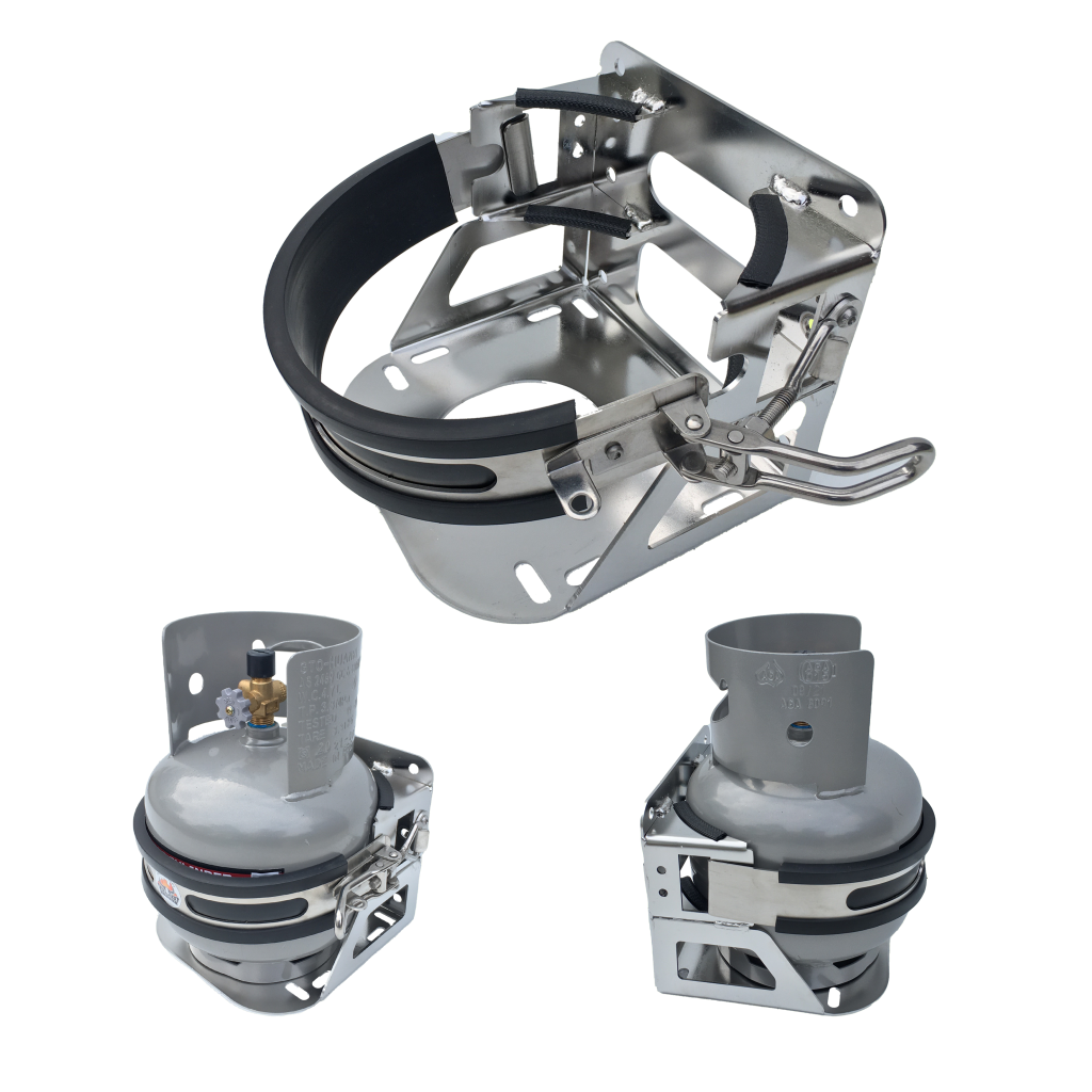

Do you mind sharing what gas bottle holder that is?
While it won't work for many awnings that need to be spaced away from the rack/vehicle, these SHOULD work to replace that plastics crap, while being a bit stronger.
Multi Brackets — Gamiviti
I can, but it probably won't help you that much as I am in Australia (well kinda close anyway)
FYI 2kg is roughly 5lb but bottles vary in shape anyway. My bottle is ever so slightly larger than the max diameter they mention. Also available in ordinary steel.
It was expensive but I needed a "proper" one because that way I can leave it on the vehicle when shipping it on the ferry, which in turn meant that I could drive through the state of Victoria without setting foot on the ground, so wasn't subject to Covid-19 restrictions.

This is how i attach my maxtrax with aluminum strap. ive cume upon a simpler solution to the mounting. i will post now with pictures.
I have stumbled upon a much simpler more elegant solution. I cannot believe it escaped me till now!
the first gap used a reversed t bolt and nylock nut through the rail and plastic stand off/separator.
I drilled it out to accept an M6 stainless bolt with washers, and bought one long enough to go through the awning bracket and everything.
take a look below:
