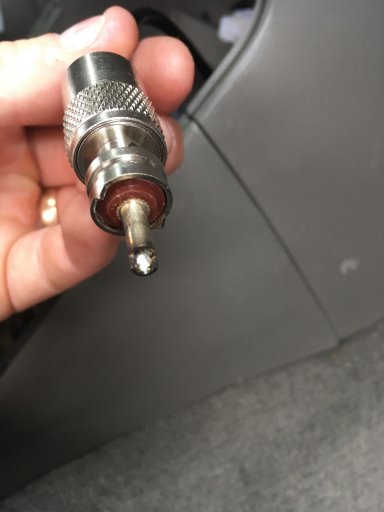

But I come with an update on the truck build!! (Insert shock here)
I soldered the feed line for the ham radio antenna using HFT solder and a bic lighter

Nice! Now, if you could enlighten me as to the point of this mod, it would be much appreciated. :laughing:

I’m glad you asked!
On occasion my reception would “skip” often driving over bumpy sections of road. I made sure the bracket and antenna are well grounded but the positive side of the coax cable is just resting on the connection. There is nothing holding it in place. So in theory on bumps it can lose contact momentarily causing the “skipping” effect.
Until now. The solder is making sure there is a solid connection on the feed line between the transceiver and antenna

Ahh! So it makes the wire larger, thereby maintaining better contact. Brilliant!
Can't say I've run into that problem with either of my Midland gmrs radios, but what a great solution.

I think it’s more of an issue with the firestik antenna feed line. All my other ones basically already have this done, but the firestik wire is much easier to run and I think the instructions on it say to do this but I’ve just been lazy
