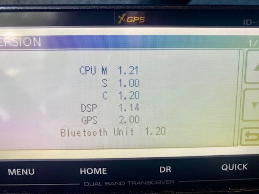

Good morning,
I just got my TECH license and have my ID-5100 installed in my truck. I posted a general question over in BOOTCAMP but wanted to dive deeper in this category. I apologize in advance for my noob questions. I want to confirm my firmware is up to date as this is a used radio. I've searched and found how to download and update my radio but cant find how to tell if its needed. I've posted a pic of the version below. Can anyone confirm I'm current? Also, I have the RT systems programming software and need to input repeaters and everything. Another member recommended the app REPEATER BOOK which I downloaded but I was hoping there was maybe a sheet, file, etc that I could just move into the RT Systems software and upload that way. My travel is limited to the western US so I dont think I need repeaters in GA for example. I am looking into my local HAM club for guidance as well but figured I'd cast a line out here since this forum has been so educational for me.

@WTSMatt Looks like you have the latest. the DSP laste uptate to 1.14 was back in Jan of 2020, the cloning cable was 1.2 in 2015 so all should be good. The 5100 is a good solid radio, have had mine for several years, biggest issue I have with it is the contrast of the screen, definatly not the easiest on the eyes in my opionon. In repeater book you can select just the area you want to download. I often select different areas when i travel and move them to a separate memory bank in the radio so can have them pre-programed if i am out of service and can not search the app for a repeater in case of emergency.
