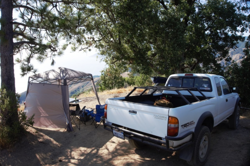

Oh and the picture is from 2 days ago at Big Sur; love me some dispersed camping.

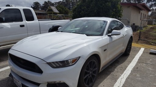

Here are the other 2 cars, the 3rd lives at my aunts house in the city -
The C4 has a performabuilt transmission and 383 stroker; been non-op for awhile now since it's way passed being street-legal.

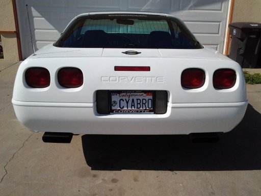

Here's one for ya -
Single turbo RX7 FD; did an auto to manual transmission swap so I had the shorter FDR as well.
I've lost count with Corvettes alone...

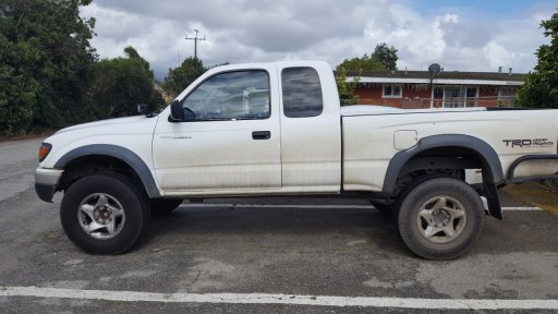

Going to piggy back on your post before this one an add, if you don't know how long your lower ball joints have been on your truck, replace them with an OEM set!
They are the weak point in our trucks and can go out when you least expect it.
To answer your question, I opted for Fox 2.5 standard travel.They offer standard travel, for 0" to 2" of lift, and extended travel, for 0" to 3" of lift. With 1st gen Tacoma's, you want to stick with 2" or less before you have to replace the upper control arms. Anything more than 2", you'll have issues getting an alignment done.
This picture was before I replaced the tires, lower control arm bushings, and lower ball joints.
I did a ton of mods within the first 3 months of ownership lol.

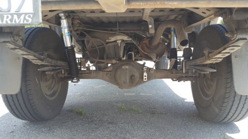

For the rear, our Tacoma's have naturally flat springs. It's when they're frowning that they need replacing. I went with OME Dakar's for the lift, flex, and retention of the stock payload.
It's a little more involved replacing these things, but nothing you can't do with basic hand tools -
One thing you have to be wary of when extending rear end travel is, you can't use standard length shocks...unless you want to have trouble installing/uninstalling them, and destroying them by both bottoming out/over extension.
As you can see, I also installed longer bump stops.
Shocks dampen the ride, springs provide lift. Having said that, since everything was new, it'll take awhile to settle. This is what I ended up with after initial install -

Since then, it took about 2 months for the springs to settle and about 2,000 miles. They provide decent flex and unfortunately, I don't have many pictures to show what they're capable of but here's one where I parked at a stupid angle -
I also don't carry much weight if at all, so I opted to install Bilstein 5100's for the meanwhile - they're an upgrade from stock, they're longer both extended and collapsed (to match the leaf springs), and they're cheap!
And the final ride height, before I buy my RTT that is -
Once I find out the actual weight I'll keep on my rig, I'll be going back to my Fox 2.0 when they're revalved. I may also go with Deaver J59 leaf springs if I decide to do a rear shock relocation mod; performing said mod will open up the option to go with 10" to even 14" shocks.
