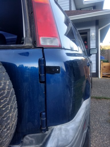

Update: I'm looking at creating/adapting a bracket to mount it to two of the 4 bolts that hold the tailgate on, with the angled bracket passing out between the gap in the hinge. Bit hard to explain, but I'm going to make a mock up and post pics when I get a chance. Not 100% set on this method, but it's the front runner atm.

The bracket I whipped up:
The electrical ground to the chassis is rock solid. Tested and got a good connection from the end of the bracket to the tailgate latch on the opposite side of the car.

That should work. I would also remove the paint where you mount the antenna so that you have a good metal to metal connection from the base where the coax connects all the way to the body.
Have you decided how you are going to run your coax? Some RG-8x through the rubber grommet would work well. Would have to take the interior panel off to fish the coax out but that would be the best way to keep it from getting pinched.

I was considering that, but the gap above the hinge is really wide, so I may just route it through there and over the upper window seal, as water ingress won't be an issue with the way it overlaps.

Bracket, antenna and cable installed. I just ran the cable into the back of the vehicle for now. I'll route it and hook it up later. Confirmed with my circuit tester that the mount is properly grounded to the chassis. Should function nicely, and I won't have to worry about my antenna falling over anymore lol.
