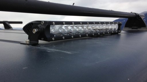

I went with a single row LED on the roof and mounted it UNDER the roof rack.

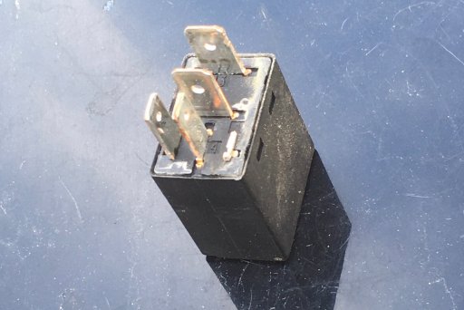

Running off the fog light switch meant they only come on with the low beam....
But if you break one prong off the fog light relay,,,,, the fogs now stay on in high beam too.

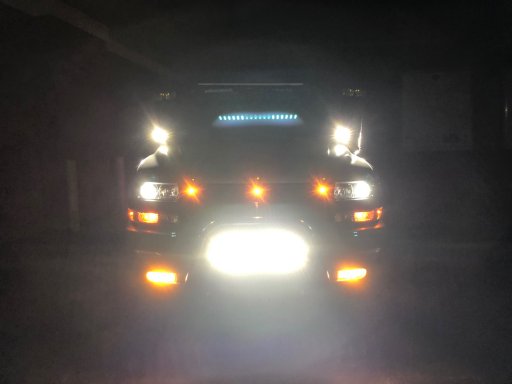

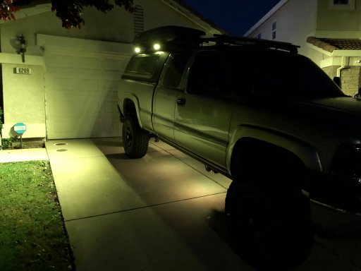

I get more light in almost all directions, I change my halogen headlights to projector style and installed HIDs. My rig already has fog lights, so I just replaced the halogen bulbs to HID as well. For further output I put a 20" flood light bar in my bull bar. I didn't entertain putting lights on my roof rack bar as others have complained about light shining on their hoods, plus whistle noise from wind.
Also installed ditch lights for side visibility. In the picture below there is some reflection on the windshield.
Lights on camper shell and below rig.

Great setup all around. The lighting looks really good, too. I'd like to put some clearance lights but dont want to drill into my roof, so I thought I would put them on my Leer 180 shell, right where it levels off a little higher than the cab. Maybe a 12 inch bar in the grill, and follow your lead with a couple on each side of the shell.
Also thought about some amber DOT inch lights, about 3 per side just under the doors, to illuminate the steps a little dimly.
Clearance markers and steps to come on when the amber parking/running lights are on, and all others operated by a small tray of switches that will either be under dash or in the sunglasses storage, or in the cubby to the upper left of the steering wheel.
Thanks! It's work in progress sorta. Thought about clearance lights as well, but the thought quickly passed. I don't want to drill, plus my headliner has seen better days. Inch lights would be a cool addition to your rig.

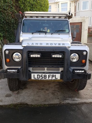

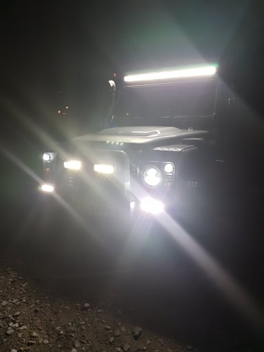

First I put on a combo flood/beam light bar from Superbrightleds for $139; 50" Super Series Off-Road LED Light Bar - 144W - 17,000 Lumens | Super Bright LEDs
In my blog; Land Rover 109 LED light bar
But since I can't have them on on the highway or roads at night I got rid of my sealed beam headlights.
I put some Sylvania LED head lights in; ZEVO LED Assembly Bulbs and Kits- Modern LED Style and Performance | SYLVANIA Automotive
In my blog; LED head lights for 109 Land Rover
Now the headlights light up the road enough I don't feel like I NEED to have more lighting on road.
