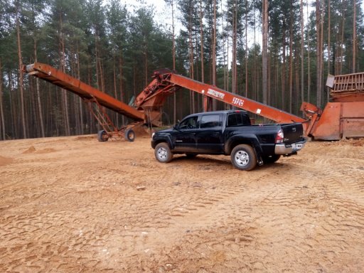

I just got a US spec 2014 SR5 tacoma, its all stock, for now. This is my first tacoma before I've always rocked jeeps, either wranglers or grand Cherokees. The first thing I wanna do is get more clearance, I'm looking at a 3in front 2in rear leveling kit with 285-75-16 maybe 285-75-17 depending on the tires I'm able to get over in Europe. My question is would I a; be able to clear tires that size with a leveling kit without rubbing and still have room to flex?. b; how much would my mpg be effected going from 245-75-16 to 285-75-17? Down the line I do want to cold a cold air intake and a bully dog chip in it also, but i played around with it this past weekend and found myself bottoming out a little more than I would like. I mainly just do trail overlanding nothing too crazy i.e deep water crossings, huge mud pits, 80 degree climbs etc. Any and all advice would be greatly appreciated either on the questions above or any advice on building it up in any way.
