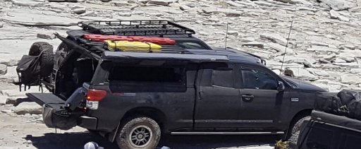

I was in the same boat as you. I have an ARE camper shell that I use to sleep in when camped. So, I didn’t want to store gas cans in the bed of the truck. Over time, I’ve acquired 4 (4) gallon rotopax. They are thin and I double stack them on my Rhinorack pioneer tray which is installed on top of the camper shell. It works great!!! When carrying all 4, I dont carry anything else up there except my TREDS. And I dump them into my main tank as soon as I can.
