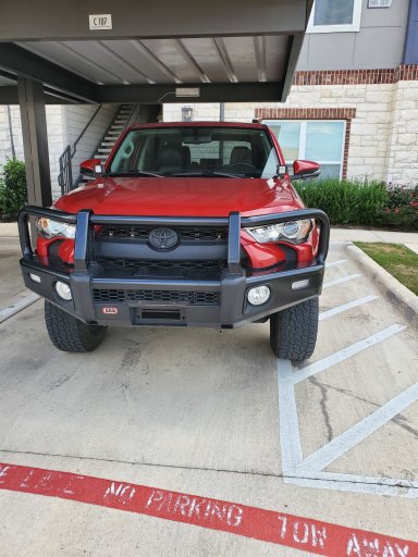

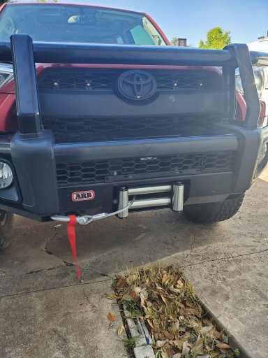

I have a 2016 4-Runner with an ARB Full Length Bull Bar front bumper. I'm trying to find the best compatible winch and don't have any experience in the winch department. Any help would be greatly appreciated.
Thanks.

I just installed an ARB Deluxe on my Montero. 8-10K units will fit. I researched and went with a Smitty Built X2O wireless w/ synthetic rope. It's waterproof as well. 4 Wheel parts installed it. They said that they get 3 times LESS warranty claims with these then Warn. Fits perfect. NOTE: With an ARP bumper and synthetic rope, you need an offset fairlead. A few companies make them for it.
