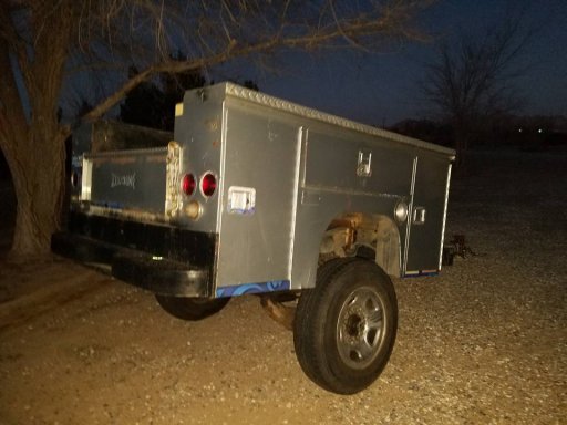

So I wanted to build a trailer so I can always have my stuff packed up and ready to go. If I get home from work and decide I want to go camping, I can just hook up the trailer and leave. I found a trailer for sale that was a utility bed of a mini truck. I went and looked at it and ended up buying it. It was mounted to a truck frame and the front suspension was a clip from a 3/4 ton 2wd chevy. This thing was sketchy as hell towing home, bouncing all over the place. I took it to a local fabricator, and had him build up a frame and get the body mounted up. So this is where it stands right now, 3500 lbs axle with brakes, wheel adapters so I can run LC100 wheels and matching size tires to my Lexus, all on it's new frame. I am working on the wiring now for the lights and brakes. Next project will be designing the lifting system so I can get the RTT up high enough to use the annex when my whole family comes. After that will be solar, electrical, water, water heater, propane, etc.
When I first bought it. You can see the sketchy suspension.

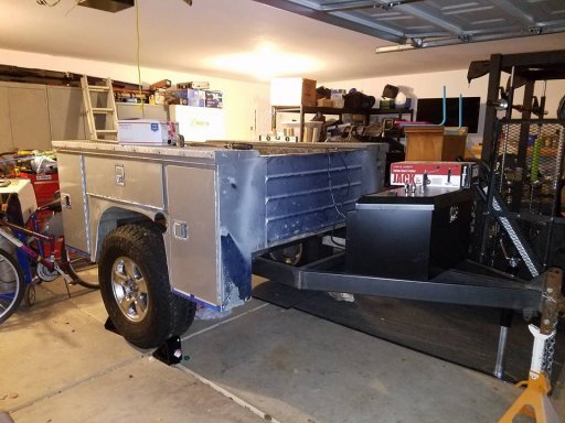

And here it is now

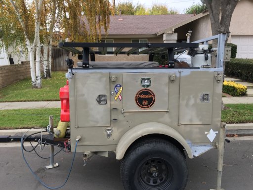

Service bodies work really well as base camp trailers the utilitarian effect is hey I can carry more and more stuff all well and good here . Now here is a minor issue the width albeit nice is a shade to large to handle a lot of the trails the overland crews use, these trails are narrow and so be it, my experience having built up several have dictated the purchase of these utility doors and building my own shell, doors as I needed and wanted them20150517_195146.jpgIMG_0008.jpgIMG_0987.jpg

Meh, mine is going behind my 100 series, and she is a fat pig!
