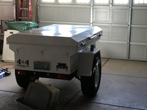

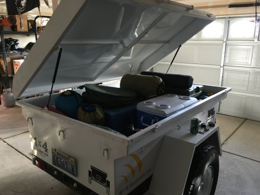

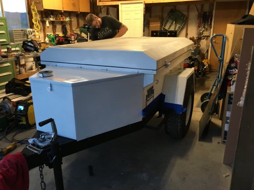

Found this trailer for $1500.00. It was a great price and did a couple of additions to it. Its a great trailer but it bounces quite a bit down trails and it gets pretty annoying.
I've heard there is independent suspension systems for trailers. Does anyone have any experience with this? Does it actually help?

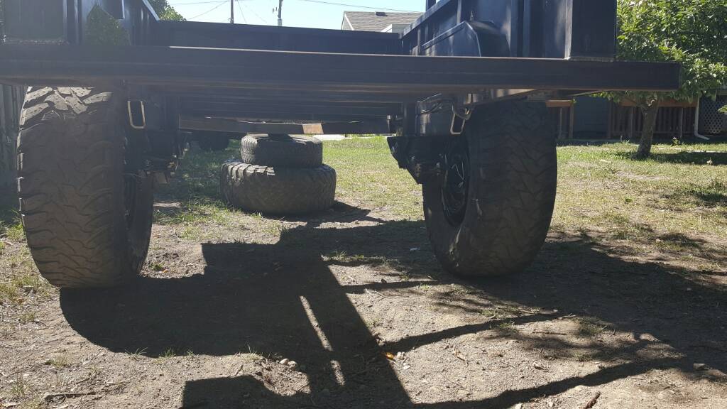

I have the timbren axle-less trailer suspension in mine and it works great no bouncing even with the trailer empty and it provides so much ground clearance so far I love it and will not ever go back to leaf sprung axles.
Sent from my SM-N920W8 using OB Talk mobile app
Wow! I gonna have to look into this. No shocks and no air bags. Whats the weight limit on these things?
Sam Wedzinga
816
I have the 3500 hd long spindle witch is a 5600 axle stubs. I only had the option to run a 6 bolt or an 8 bolt pattern with this. I should have gone with the 2800 hd long spindle then I could have matched the bolt pattern of my jeep. Take a look at their website and call the tech line they were great help for me. They have a video or 2 there as well showing how it works the rear rubber block is your spring the front block is your shock works great I think
