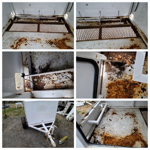

THIS IS A WORKING BUILD, so be patient please... I found this trailer on FB marketplace in November for $350 took 2.5 hrs of driving to get to it, but it followed me home. trying to keep this build within a good budget I plan to keep adding features, and items as I go.
it is an old 2002 Police Radar Trailer max weight is rated at 1500lbs with a Torsion axle
here is the trailer as I brought it home... it towed great behind the tacoma at times didnt even feel like much was back there. I dfinitly will have to get bigger tires on the trailer to level out the tow...
316036964_10159242771587794_3921544996107992445_n.jpg315745669_10159242771677794_3922385457865601420_n.jpg316237403_10159242771372794_4127973541094660167_n.jpg
it does have an odd ball hitch I have never seen before... but it makes it SUPER easy to add a lock n' roll hitch in the future if I want... just pop the pinn out and slide the new reciever in..
the trailer even came with some tools, lots of nails, and electrical conduit pieces and parts (I think a plumber/electrician/handyman was using it for storing and transporting tools, parts and equipment.... the trailer was recovered and towed away, posted in the paper as recovered, but no-one claimed it.. they posted it online.. so I went and bought it... registering trailers under 3000 lbs no title is required.. just a bill of sale...
316258019_10159242771062794_1956723538377934375_n.jpg316102286_10159242770552794_6943983951606330474_n.jpg316416918_10159242771047794_1372395461292209401_n.jpg315447934_10159242771122794_857330199427188872_n.jpg316426999_10159242771732794_2863467456360086757_n.jpg

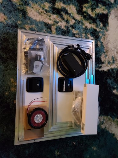

here is what I have so far to get working on...
1- 30x24" top hinge hatch to replace the rear glass (I will need to find/source longer hydraulics as these only open about 90degrees and may become an issue...
1- 12x24" side hinge door for the drivers side to access the front of the trailer
1- 7-pin trailer harness
wiring bits - self soldering waterproof butt connectors, and 1/4 loom
new black marker light grommets
new flush mount brake/turn signal lights w/ reverse
roll of Dicor Butyl tape for the doors
and an LED license plate light
I plan to do a bunch of rust restoring and a few mods before adding most of this stuff, so the pile will only get bigger.

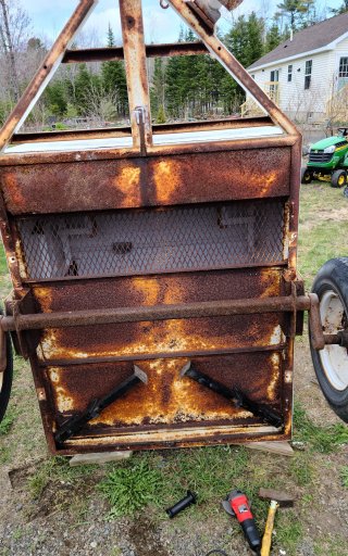

Little progress today... got rhe grinder out, and some rust fixed....
I left that front panel as it's being removed wire wheel on the grinder made quick work of the surface rust..
Unfortunately I found out that the 8-258 dexter hubs on the torsion axle cannot be swapped my only real option is an adapter for $100(or so)... otherwise the options get expensive... (timbren axle-less suspension with 4" lift and brakes.. which can be done for about $1400-1800.. was really hoping to hold off on that expense.... so for now I may just get adapters and run my TRD OR rims and tires..

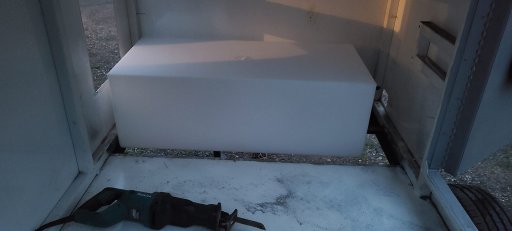

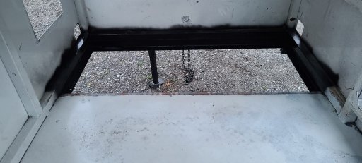

did a little more work... tore everything out of the trailer... and I cut the openings for the new doors.
for now they are just set in.. have to complete the painting.. and I am not very satisfied with the rattle can paint job.. thinking raptor liner....
I did get my 40 gallon water tank.. so I threw it in after cutting the door openings to see how it looked and what space I had to work with... I also did some calculations on the weight... with a full water tank... we are talking 330lbs or so.. its making me rethink how the trailer will act with a 3/4 full or half full tank... thats 150lbs of side to side momentum, and may cause me trouble down the road.. I may need to swap down to a set of tanks in the 15-20 gallon range and make a valved system to feed the pump..
I then thought about just lowering the COG of the water tank, and figured out that for the price of a piece of 1/8" angle iron I can drop the floor nearly 3 inches in the front... so i cut out and ground out the crossmember in prep for this.. I will add support under the floor by welding on a piece of angle iron (probably the piece I cut off, once I clean it up)..
