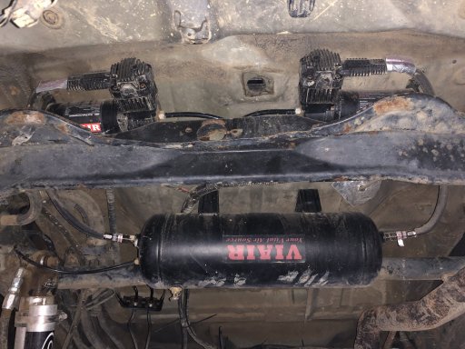

I went with a Viair dual air compressor and 2gallon tank setup for airing up the tires after I air them down.

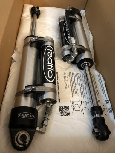

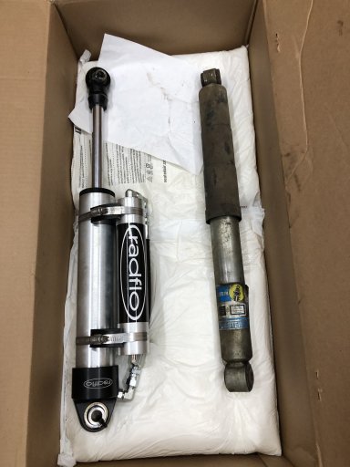

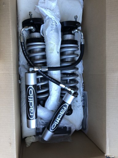

While all that was nice I knew I wanted more, so I envetually decided to start collecting components to do the Titan-swap (if you're not familiar with Nissan, you can swap in Titan components into Frontiers and Xterras- everything from the engine and transmission to the suspension and other drivetrain components). My titan-swap at the moment is just the front differential and the rear axle are no longer the R180/C200k combination, they are upgraded to M205/M226 diff/axles with a locking rear differential. I titan-swapped with Radflo 2.5 coilovers and shocks with remote reservoirs as well as various other components including Alcan custom +800lb over stock leafpacks. I carry a lot of gear hehe. I'll have a list of my loadout below.
Here are the shocks

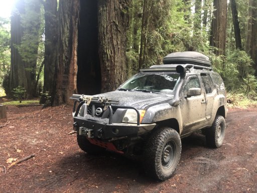

I've done a few roadtrips with the new setup and I'm loving it so far, I just need to do more!

Viair twin 400C + 2.0gallon airtank OBA setup

So far the springs in the rear are stiff but starting to soften up- they're very heavy weight considering. I made a mistake of ordering frontier-length titanswap rear shocks and they're an inch too long so they bottom out without heavy duty shocks, plus I weigh in at 6300lb when I'm fully loaded.f
I do recommend Alcans though- they'll spec you whatever weight you want!
